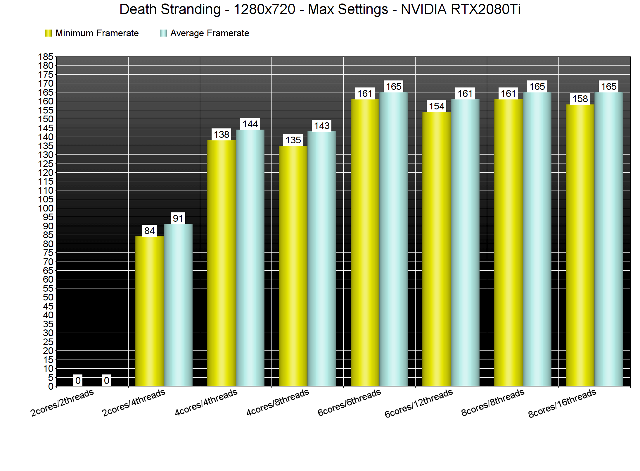

Alright W1z i found a few games but gees it was pretty tough looking for poor performance on a 4C/8T CPU.
They really do seem to be still ok for gaming!
Anyways this was the best I could find without doing my own testing on my 12700K and installing a 101 games etc..
The systems was a 9900K with cores and HT turned off etc. Going to list them in no particular order.
I can list some more games but really what was happening was that the averages were the same but the minimums were slightly lower than its more core counter part.
It was a mission for me to find many games that didn't run well on a 4C/8T CPU and with the IPC rating of the 12100 id say its a very capable CPU for gaming atm.
But as you can see from the graphs I have posted, you can clearly see that 4C/8T is only just starting to show its age.
All the games I have shown here are probably not what your looking for on your reviews so I've tried my best : )
