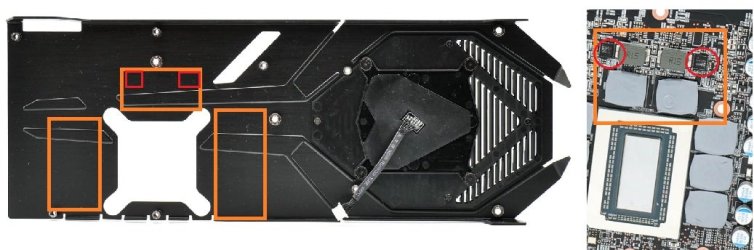

Make sure when you add thermal putty or thermal pads on RD back plate you cover drv mosfets as well, there are 2 columns of drv mosfets on the left and right of the VRAM.
I added just the picture of the 2 easy to miss.
IMO no backplate thermal pads on such condensed PCB is a a big NO.

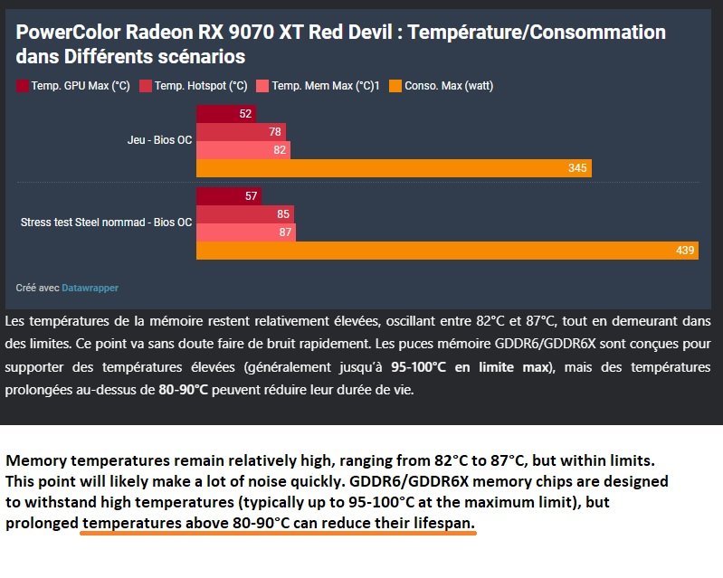

This review shows that in Steel Nomad test RD VRAM reached 92 C.
PCBs contains Copper layers, sometime ceramic layer too which will make heat transfer faster trough PCB.

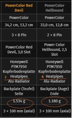

Why bother removing the LED panel? Why not just buy a cheaper model that doesn't have it in the first place, like the Hellhound for for example? :slap:
While the weight and number of heat pipes offer a more silent and better cooling with RD card, I can easily take off the silly panel and add thermal putty for the back plate making it even more efficient and silent. I can not do that with HH card can I? :slap:
You ignore 3 more heat pipes and over + 300 gr heat sink but I can't. Why are you ignoring the differences when we actually talk about cooling?:slap: We have different mindsets, yes but try to be objective pls.
And whatever I do with HH in terms of added stuff, will be inferior to RD in terms of cooling not to say RD has a better voltage stability in the silent BIOS.
How does the Hellhound have 4 heatpipes when the Reaper has 5? Something's not right there.
The hunt for silence is a valid reason. I'm just wondering where the line of extreme costs and diminishing returns is.

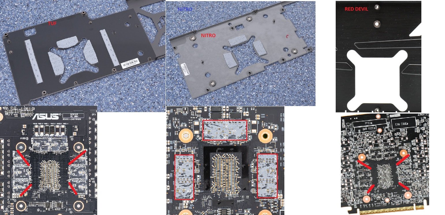

Let me show you how bad it is in the example bellow where they literally cutting corners:D and never the less 2 expensive cards. Asus TUF and PC Red Devil.
2 memory modules are half cooled from the back while another 2 only 70% cooled. Resulting in 4 modules/card not properly cooled.:mad:
Sapphire did it right in covering the entire chips but, they failed to cool the driver mosfets from the back.:ohwell:
However the point was that HH has 4 heat pipes while RD has 7 and over 300 gr heavier. So IMO is worth buying the RD, remove led panel and add thermal pads to link the back plate.
As for the second point.
Costs IMO will worth in the long run in stability of your card and longevity.
Fiddling with settings to stabilize a card with too hot drv mosfets and VRAM will be time consuming, IMO is not worth it.
