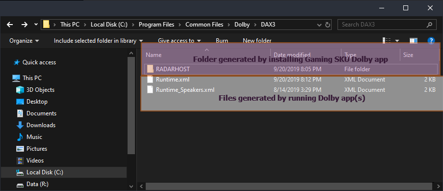

I recommend you to have a clean install: not xml files on dolbyaposvc or commmon/Dolby folders and delete radarhost folder, uninstall Dolby DAX API Service, uninstall all Dolby apps.
Place XML on dolbyaposvc folder firstly, then install Dolby DAX API Service components -> FX Configurator. Installing Dolby app be the final step.

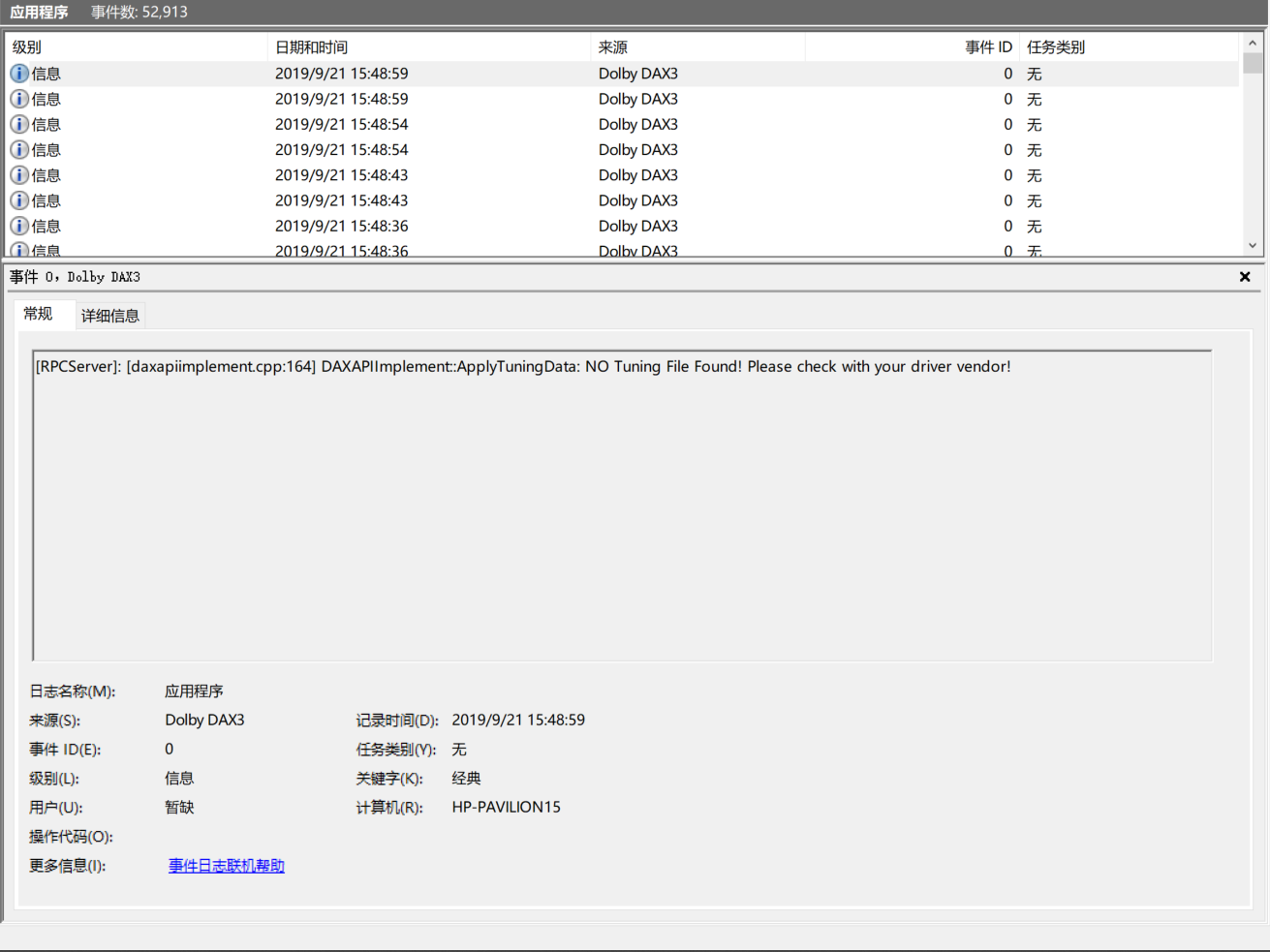

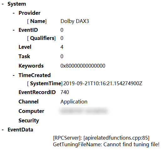

Still exactly the same issue. It started not long ago and before that I was able to use normally. Not caused by windows update as Windows did not update when it stopped working. I'm on 19H2 Insider 18362.10019. I did not install any dolby apps yet. I did clean uninstall/reinstall the APO driver and all the components. I chose Dolby PCEE 4 and Dolby DAX API and Creative APO 2 for APO driver installation. However I dislike all other sound processors as they all come with some distortion, Dolby Atmos is the only one that I love.

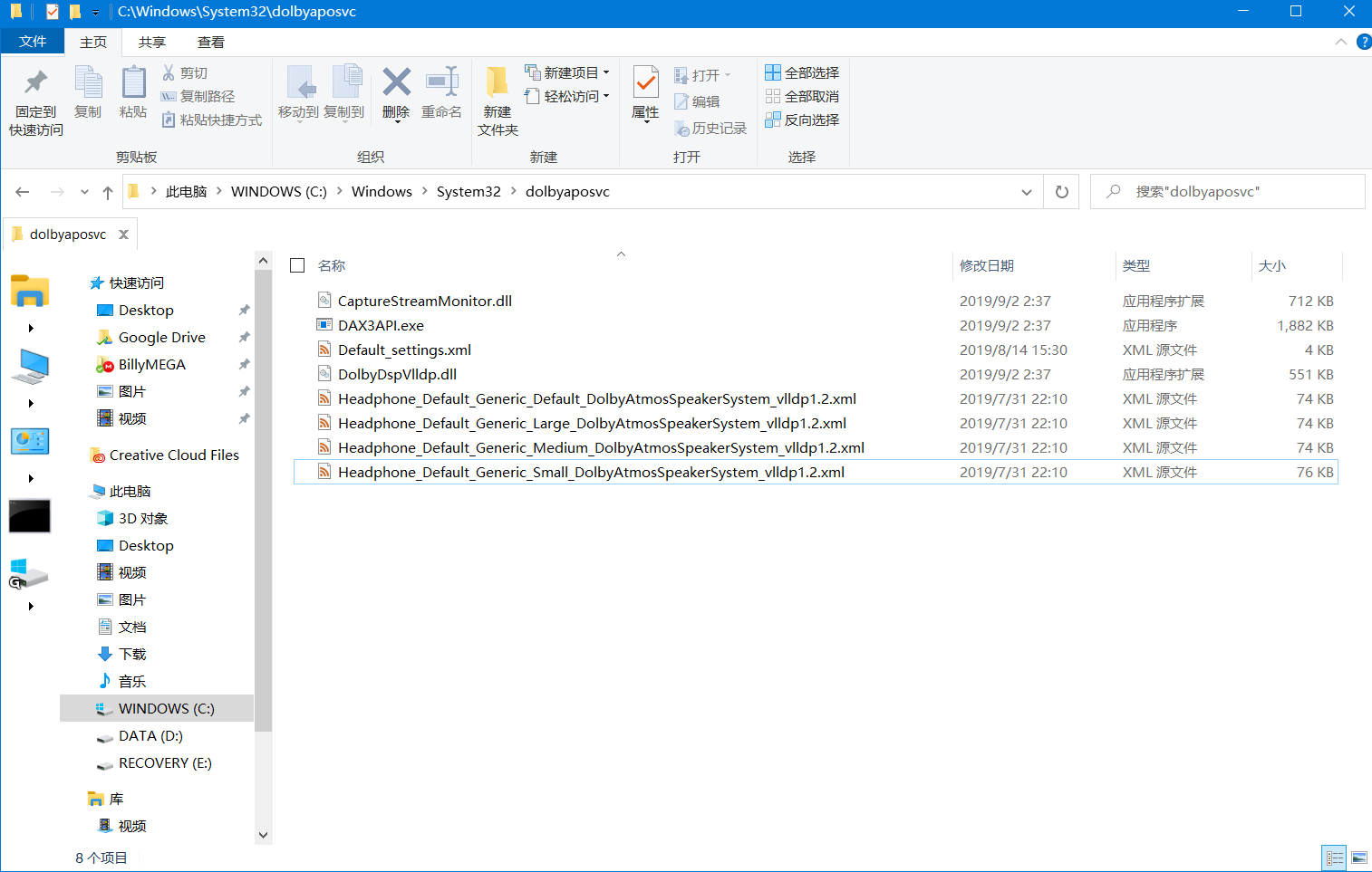

Default.xml, not Default_settings.xml. Rename.

Yes you are right. There is no Default.xml under the Headphone folder, so I went to the Speakers folder and found the Default.xml which is 73KB, much bigger than the one I renamed (4KB). And it works! Thanks a lot!
