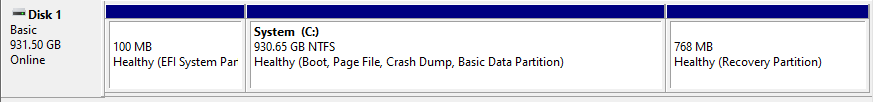

I re-installed Windows 11 just the other day. Clean install, deleted all the partitions and ran with it. This is what it set my disk partition for C:/ to.
Wow what a mess.

Boot drive is currently gap city. EFI -> gap -> OS -> gap -> Games -> my unallocated (I had dumped the 1 gig RE here when trying to fix it).

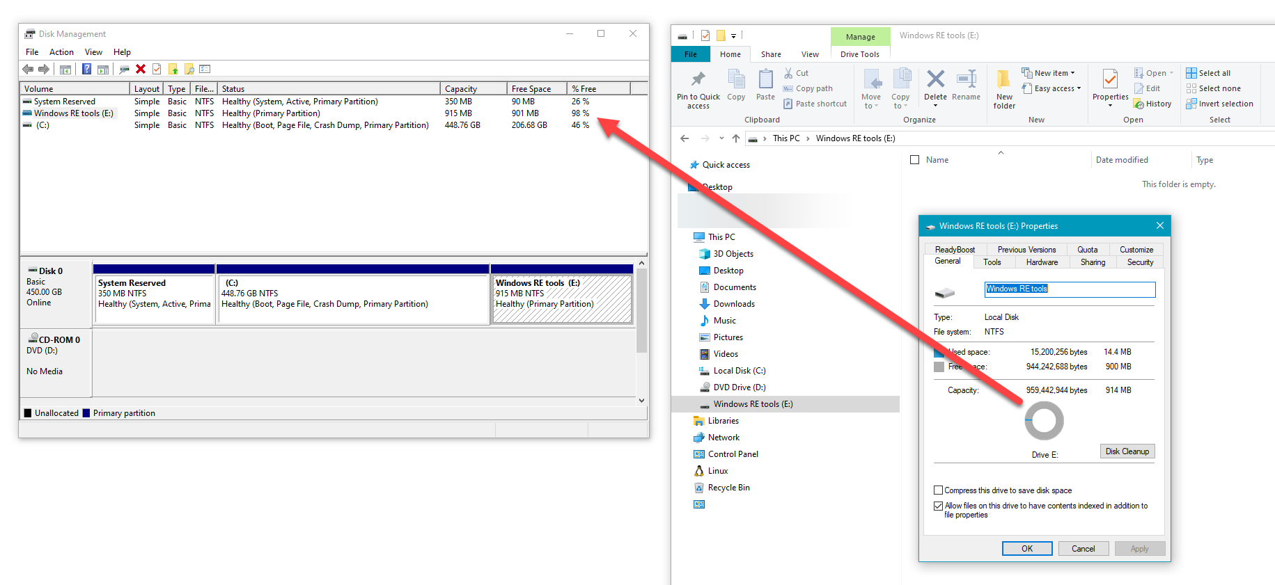

So I decided to give this a try finally because I needed to expand my VM disk space and the recovery partition was now in the middle of the disk preventing me from expanding the C partition. :banghead:
I was successful in removing the partition, resizing C, creating and resizing a new recovery partition, re-enabling WinRE, and applying update KB5034441, or so I thought from an error free experience.
But wait! It's kind of hard to recover from a recovery partition that is almost EMPTY right? (I didn't have the instruction to hide the drive letter and noticed the unrelenting free space)
Still I managed to get into the recovery menus and reset the PC. I guess it was successful but I was expecting something more to be in the partition? I did not get to try all the various options yet.
It says it is empty, but it is not.

Hi,
You can't go by what DM says it's dysfunctional as hell at reading system partitions.
Use free minitool or any real partition manager app instead for accurate readings.
Hi,
I've never seen disk properties misreport disk space before. I'll do some more investigation later tonight with other tools.
