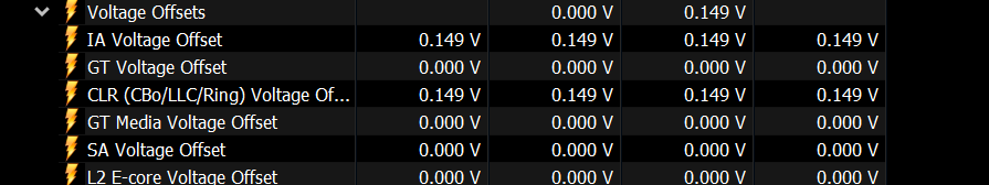

Tried that one, nothing changed. I have tested the voltage offset values in HWinfo, after I saved everything in Throttlestop and exit there, but it shows +149mV for both core and ring, which is definitely not the same as in TS FIVR. I also have tried EC reset, didn't work.
Other users have reported the same thing. HWiNFO seems to report the mV Boost value when you are using that. I do not think this is correct. I do not own a similar laptop with an HX processor so I have no way to prove this to you. Other HX owners have achieved improved stability when using mV Boost so it seems to be working correctly.
