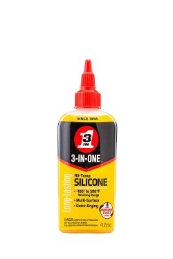

All thermal pastes will eventually dry out; they aren't expected to stay liquid forever.
Silicone oil is good to 500°F, so one might not expect much drying out at say 200°F
NTH1 was pretty good Arctic dries in months and the XT50 is much less viscous.
Drying may actually not be an issue, a solid is less susceptible to pump out.
