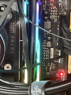

Need HELP, pic attached new build Gigabyte x670 Aorus Extreme new motherboard w new 7950x3d- power up STUCK on CPU LED RED,POST LEDS BLANK, no CODE
Dane7
May 27, 2023
2 (0.01/day)
Gigabyte x670 Aorus Extreme, AMD 7950x3D
ASUS RYUO II ARGB CPU water cooler
ASUS ROG THOR PLATINUM II 850 watt PSU
ALL NEW IN BOX SEALED btw, QFLASHED to latest bios using USB bios flash port successfully , did this with no cpu and no ram successfully. Watched the led on the usb stick and it took about 10 minutes to stop flashing and complete the bios update to the motherboard. The integrated motherboard HDMI port and DISPLAYPORT cables are both connected to monitor that has been tested and is used daily btw.
SWAPPED in another brand new identical x670 gig Aorus extreme motherboard
SWAPPED in another brand new 7950x3d
Then TRIED EACH CPU and ram kit in all possible combinations ON EACH MB
It’s run powered on 1 hour and no change, just the same cpu led is red on both motherboards and the post led code display is blank and never powers on at all both mb
cleared cmos several times over the last 4 days and done numerous reboots
Also no dram or vga motherboard LEDs have ever shown red, green or anything, they never turn on, just the same red cpu led
Tried 3 different memory kits , putting each stick of each 2 stick kit in dim slots in slot A2 and B2 only , which is clearly labelled on the mb by gigabyte as the first 2 slots to use. Never tried more than 2 sticks of the same kit, never mixed or matched or tried 3 or 4 sticks. tried just 1 stick in only slot or only slot B2 from all 3 kits.
same result, red led cpu and nothing else no matter how long the system is powered on.

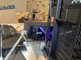

checked the asus thor psu LED , it never gets higher than 24 watts and sits around 23-24 watts for hours
so it seems the cpu is never powering up

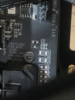

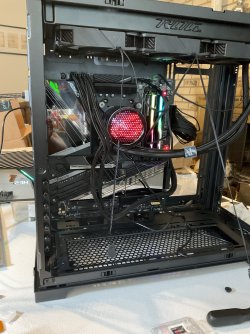

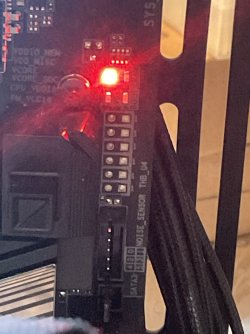

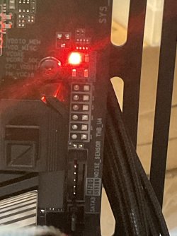

SUMMARY so far:
never gotten video from the integrated hdmi or DisplayPort even once, no signal even sent to monitor
never have the two post LEDs even powered up once, so never gotten a code, just the red led for the cpu that’s directly on the gigabyte x670 extreme motherboards.
Ive built dozens of computers from scratch, most recently Intel x299s, amd 59xx based pcs using gigabyte Aorus extreme or MSI mother boards. This is my first new and 5 system. I’ve had it looked at by two other experienced pc techie geeks and short of multiple brand new hardware components defective out of the boxes we are googling what to try next.
I’ve done my best to supply enough not to waste anyone’s time. This mess has consumed many hours of my time this past week.
Other than some required cpu fan or other fan or power cable not being connected to the mb ( one of the radiator FANs is connected to the cpu fan power pins on every attempt btw from the very start) the only other thought is to try a 3rd power supply??
At no time was either brand new amd 7950x powered without the water cooler mounted and screwed on properly so it seems unlikely it’s the cpus.
2 bad brand new gigabyte x670 Aorus extreme motherboards out of the box possibly ??
3 different types of bad brand new G.skill ddr5 memory kits bad out of the box possibly??
wide open to any ideas for am5 related new pc builds you ran into on ANY x670 motherboard brand?

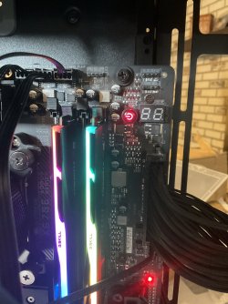

attached some more photos. Some interesting ones are the photos showing
1. blank post led bank, never shown post codes or powered on even once
2. the low 24 watts of power drawn from new 850 watt platinum power supply
this happens with both identical gigabyte x670 Aorus extreme model motherboards and both 7950x3d processors.

however in my post first line under the summary heading says never gotten video from the on board video out either the hdmi or displayport even once. Never once a signal detected.
since those integrated hdmi and DisplayPort outputs have never given any video or a video signal been detected by our daily used working monitor not willing to risk a new 4090 in these motherboards just yet
based on other web sites, the integrated dram LED and integrated vga LED on the motherboard need are next. These two are next in the bank of LEDs gigabyte literally put on the motherboard itself
