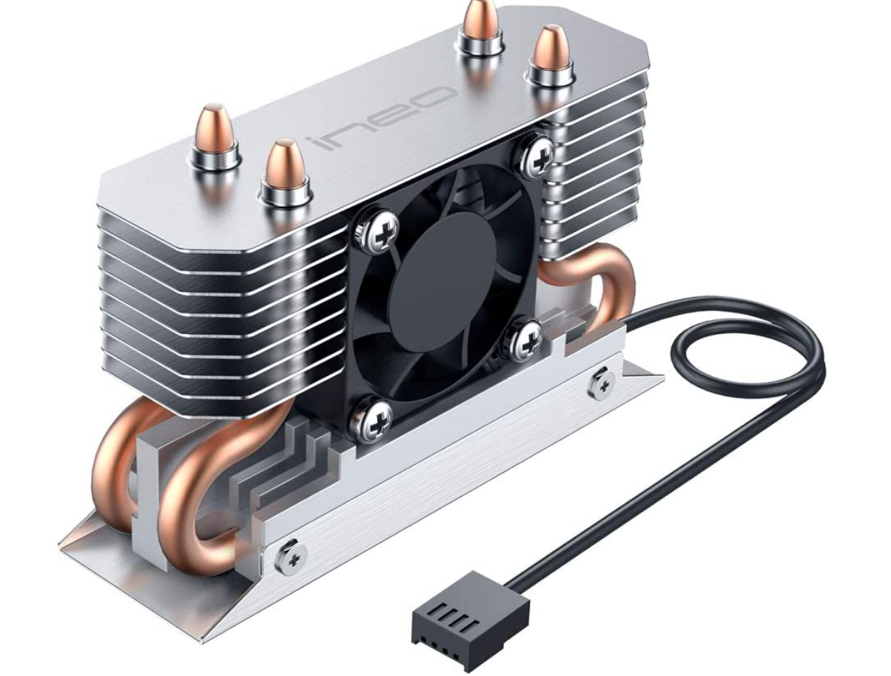

I added three active heat-pipe M2 coolers over the memory. They are instantly getting very hot, which means they are transferring heat off of the card quite nicely. I wish I could read the memory temperature for the card, but ya know.... that is privileged information that NVIDIA does not think we should see.
The card no longer Thermal Caps while mining at stock speeds. I seem to be able to stay un-capped with a 200mhz memory overclock now too. I also flashed the EAGLE OC BIOS onto this Eagle non-oc card, so now I can raise the power limit to 110%, because I obviously need more heat :)
Overall, I wish these heatsinks more more effective than they are. But they seem to be much better than nothing.

Interesting find, do you think those heat sinks would help an FE card? Where did you buy the sinks? Thanks for reporting this odd behavior.
on amazon, you can find an assortment of heatsinks, ones intended for use with M.2, or chipset cooling. THESE can be adjusted to be positioned the way thats most convenient for your set up. but there are many different ones.
i used to order custom made fans of pretty good quality from a guy on ebay. he custom 3D printed them, & used great motors, all the way down to super tiny fans. if you search RAM , chipset, or VRM cooling , im sure you'll find a heatsink that you can use.
This ones a nice small full copper heat pipe design. its pricey due to the copper, but thats normal
