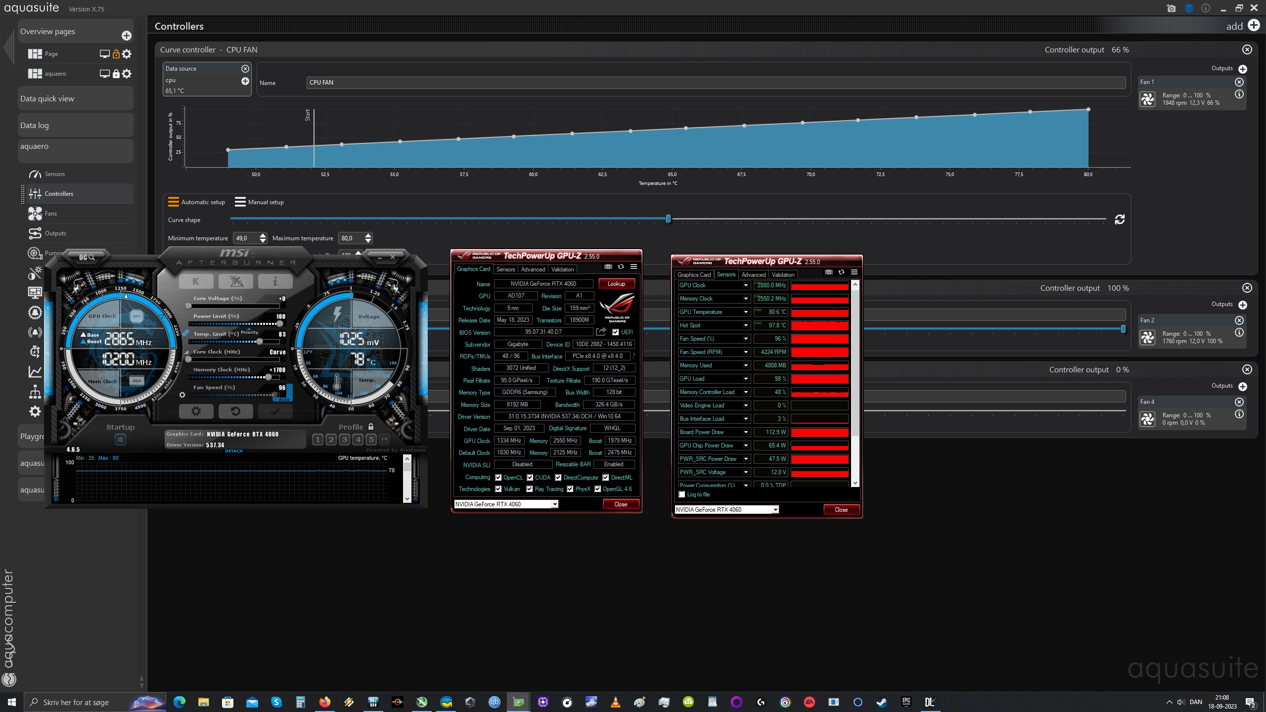

So a quick question.
I just got my hands on gigabytes new little RTX 4060 with low profile cooler. So cooling is off cause limited.
Power is locket to the stock 115 watt. So power cant be raised.
Now i am playing around with overclock to get as much out of it as possible. So 200+ on GPU or 2880 mhz to 2900 mhz with a lillte undervolt from stock 1.05 mv to 1.025 mv and right now 1700+ on memory in msi after burner. Thats deffently gives a little bump in performance.
But here comes my possible concern. specially hot spot temp. right not gpu temp hovering around 76 C to 80 C peak. While hot spot hovering around 92 C to 95 C with a short peak of 97 C.
I find it a little toasty for the hot spot. But remember it´s a low profile cooler on it with 3 fans, so cooling is limited. It´s more are this safe hot spot temp (the normal llgpu temp are high, but should be safe, my concerns is mostly the hot spot) or should i dial back to lower hot spot temp?

So i made a run. Power limited big time because of the stock power limit. Keep GPU score down. PEak hot spot temp was 93 C
Seems fine, I mean it's a miniscule cooler what do you expect.
I never exspected great temp from it. I only wanted to know if ot was with in safe limits. To high temp will degrade or even damage the gpu in the long run if to high.
So to all. I would still like to know if these high hot spot temp is safe or not?

This is a complicated topic.
Basically, on the GPU die there are hundreds of temperature sensors. What GPU hotspot temperature shows you, is the maximum measured temperature of all the sensors.
The temperature of concern on a silicon chip is 125C. You don’t want any part of your chip to be above 125C, because at that temperature the structure of the chip starts degrading.
In ye olden days, all you had was 1 temperature sensor on the middle of the chip, and then the GPU engineers would calculate the reported temperature, when parts of the chip got toasty. So they would calculate that when there are hot spots on the chip of 120C(5C gap for safety), the temperature sensor would show 95C. So they would set the max safe temperature of the GPU at 95C. And as long as you were below 95C, you would be pretty sure that no part of your GPU was overheating.
Nowadays, you get the sensor grid, so now the GPU manufacturers get 2 numbers to play with. They get the “average” measured temperature, and the “hotspot” measured temperature. This temperature measurement still happens on the surface of the silicon chip, so there are still hotspots inside the chip that are hotter that the “GPU hotspot temperature”. The process is the same, GPU designers calculate the max safe temperature of the GPU chip, usually 120C again, and then see what numbers they are getting on the “average temperature” and “hotspot temperature” sensor. Usually the average temperature sensor is in the range of 92–97C depending on GPU. The safe temperature for the “hotspot temperature” sensor, is in the 110C range. Basically, the “hotspot temperature” sensor is closer to the true value you care about, but still only halfway there.
So. As long as the GPU temperature is below 95C, and the hotspot temperature is bellow 110C, you will be fine.

Thanks, very useful. So bacically i should be safe accordingto this.
