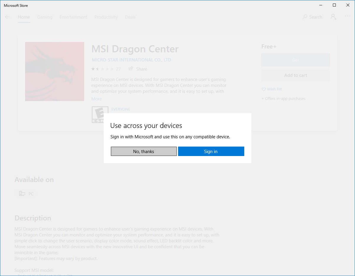

You can for now get away with downloading from the Microsoft Store. You can bypass the account login prompt, and continue on with the download.
Really? Everything I've ever seen requires an MS account and being logged in. I might have to try that just for giggles, not that I'll use it..
Click on the "No, thanks" button in the dialog box.
Automatically will download, and install.
What happened?
