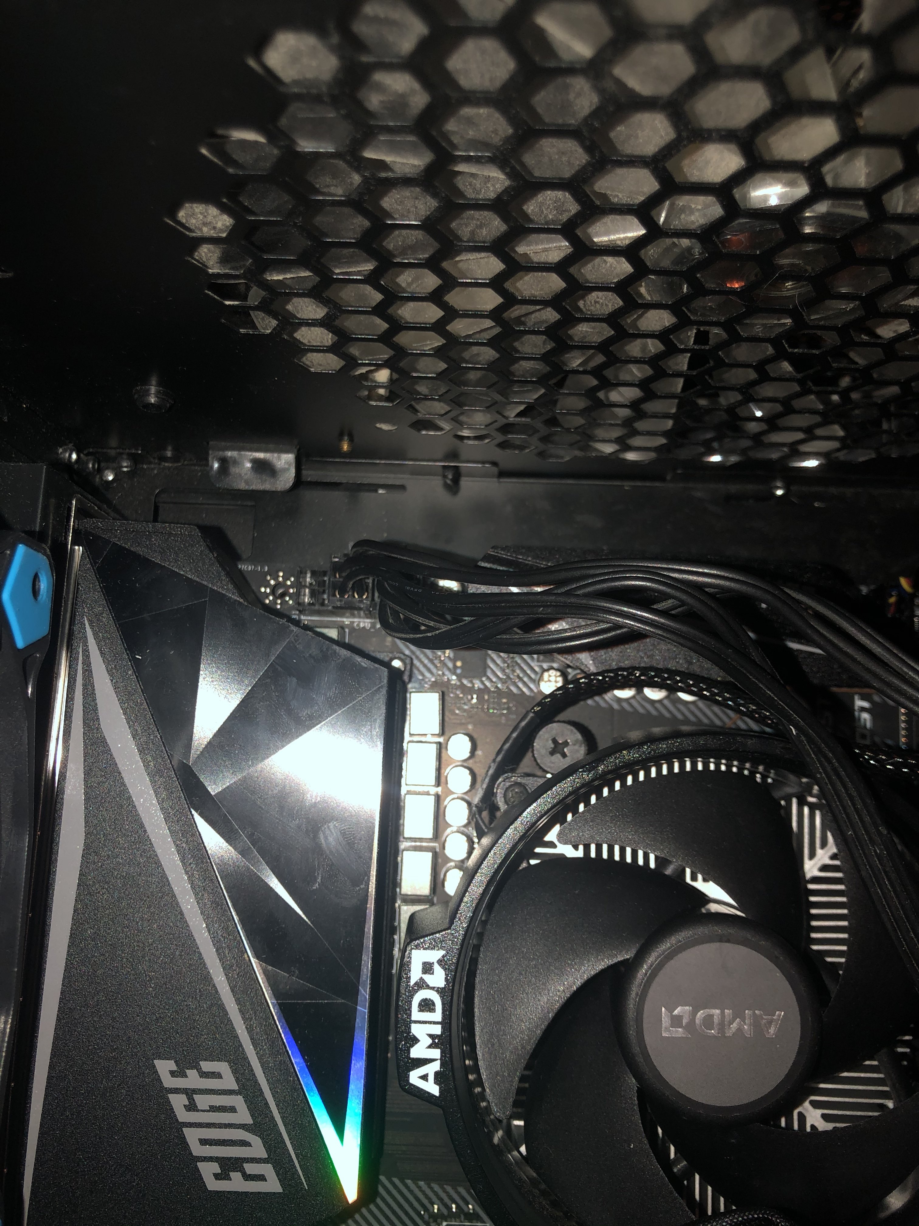

Not sure if this helps hopefully it does
The CPU power port on the MB. Your board has an 8pin (CPU_PWR1) and a 4pin (CPU_PWR2).
In the picture, it's hard to see, but it appears you have a 4pin plugged into the CPU_PWR1 spot and a 4pin plugged into the CPU_PWR2 spot. I don't know what PSU model you have, so you could have a dedicated 8pin power connector for the CPU_PWR1 port or you could have 2 - 4pin power connectors. You need to make sure you have the proper cables from your PSU plugged into the 8pin power CPU_PWR1 port.
I'm not sure why you need that extra 4pin power port for the CPU, maybe it's for the higher-end CPUs (such as 3900x) to help deliver enough power....? I haven't read anything specific about the needs for the second power port in the manual, but I didn't search through it that well.
I don't believe you need to have anything plugged into the 4pin (CPU_PWR2) port to power your CPU - some reddit posters have mentioned they do not use the second, 4pin (CPU_PWR2) port, they just plug in the necessary power cable(s) to the 8pin port and their systems run fine.
Yes, that is the way i has it before and it worked then. don’t know why that is but it is.

Move the power cabling to the 8pin port. don't use the 4pin. I've seen folks mention the 4pin isn't necessary and it's just a gimmick....but I didn't follow up with any links they provided on where they heard it.
Those two fans (top and rear) are backwards, btw.
Can we get a non-blurry pic of the CPU power pins? Most boards work fine with just a single 4 pin, but its worth looking closer at - as mentioned above, you may have it in the wrong 4 pin side (and 8 pin if available should be your first choice)

Is this what you were asking for?
The arrangement of the 8 pin from the power supply split into two 4 pin connectors over the 8 pin connection on the board , and the 4 pin connection isn’t correct. Try just the 8 pin connection on the board with the split 8pin from the power supply combined into the 8 pin connector.
I am starting to think it is an issue with the CPU, I tried putting in an 8 pin adapter, then put in the 4 pin with the 8 pin and nothing worked.

It looks like you split the 8 pin and connected them weirdly - they should be joined together, and connect then.

You said you tried an 8 pin adapter and then the 4 pin, you didn't say if you tried the 2 x 4 pin plugs together in the 8 pin socket.

Isn't the 8 pin on the left and 4 pin sup on the right?
Yup, 8pin should be plugged into the left cpu voltage connector.
Hi,
4 pin is optional but 8 pin has to be filled first.
Wouldn't call additional 4 pin a gimmick though it's for additional power for overclocking which is no gimmick it's good clean fun :-)
