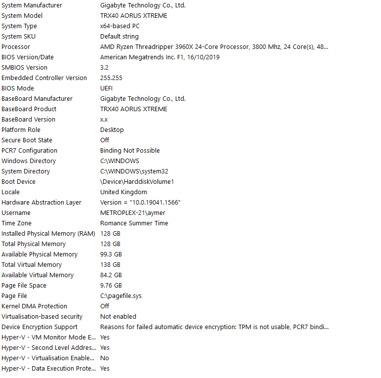

Hello all! I recently updated my PC setup and been having some performance issues!
First up I'm a VFX / 3D animator working from home so this PC setup isn't designed for gaming, but I assume its the same load / stress and rendering absolutely destroys a computer.
I recently got a custom loop and 4 x 3090s and been seeing some performance issues on Octane Render in Cinema 4D. I opened GPU-Z noticed some things:
GPU load is running at 99%
and the PerfCap Reason Pwr.
I attached my computer specs in this post and they are also present in my profile.
So I installed EVGA Precision, lowered the power target of all 4 GPUs to 60% to see if that had any impact on the PWR consumption and it didn't change one bit. I noticed the noise of the GPUs went down considerably however.
I tried under voltage with MSI afterburner but that didn't seem to do anything.
I've attached a screenshot of GPU-Z mid render, this is just showcasing one of my RTX's, but the others all have similar read-outs.
Please bear in mind, computer hardware specs and testing is relatively new to me, so please have that in mind!
Unfortunately most VFX artists I know don't know a thing about this sort of stuff.
Any help would be greatly appreciated!

Greetings! I'll try this, would I be trying to aim at the GPU clock MHz or Memory Clock MHz for the targetfrequency?
I only got worried that once one of my renders finished, the computer shut down immediately. I looked into troubleshooting and a few people on the OTOY forums suggested that it was to do with my PSU not having enough power.
There's no SLI bridge on that photo.
Correct. I had the computer put together without the option as as Octane Render recommends disabling the SLI option in your NVIDIA control panel to maximize OctaneRender’s rendering performance.
Also whilst I have you guys here, I'm getting VRAM temps of around 100-106°c on my GPUs whilst rendering. Just wondering if that is normal considering I have a custom loop. A fellow artist said that its not normal but I wanted to get another opinion. Have in mind I don't have any active backplates (do you think its worth me getting some installed?).

Yeah I did look at getting 2 x PSUs but most people assured me the 2000w was more than enough for 4 x 3090s. I had this setup put together for me by a local computer shop and I feel they really messed up. I'm not sure if its daisy chained, does this photo show that?
Also how do I balance the power on the pins? (I am total newb, but been trying to learn!). Looked on other forums and the voltage of the pins should all be around 12v - so seeing as there is a mass variation in voltage, maybe thats what is causing the warning lights to go off?
