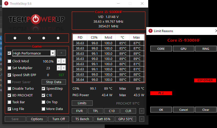

Despite messing around with plenty of settings, I seem to constantly be tripping on PL2. It's not prolonged throttling, but just small trips that keep occurring. This is despite low power consumption and low temperature - nowhere near the limit I've set for PL1 or PL2.
(CPU core and cache have the exact same settings)
Any help would be appreciated. Did I enable/disable something I shouldn't have somewhere? And if anyone has good recommendations for other throttlestop settings, please do share!

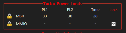

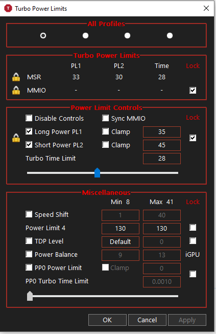

Yes you did! :D
You somehow managed to lock the MSR PL2 power limit to only 30W. That can cause power limit throttling.
To unlock the power limit register you might have to completely shut down your computer. The typical Windows fast restart might prevent this register from becoming unlocked.
In the Power Limit Controls section of the TPL window, clear the Lock box before you shutdown. It is OK and recommended to lock the MMIO power limits but there is rarely ever a need to lock the MSR power limits. I would set Long Power PL1 and Short Power PL2 both to 60W.

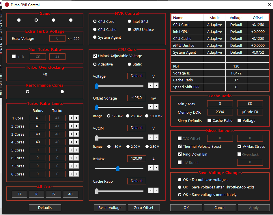

No one else seems to be undervolting the System Agent. Is there any reason why you are doing this?
Do some Cinebench testing. Many users get better temperatures or better results by undervolting the core more than the cache. Somewhere around -125 mV for the cache and -175 mV or -200 mV for the core usually works well.
I like setting IccMax to the max, 255.75, for both the core and the cache. It might not make any difference. My only goal is zero throttling.

I've raised it to 40W
Follow my suggestion and set both power limits to 60W. Check the Speed Shift box in the TPL window.

Show me screenshots of ThrottleStop while your CPU is throttling badly. Include the Limit Reasons window in your screenshot while Cinebench is running. It is even better to turn on the Log File option before you start doing any testing. When finished testing, exit ThrottleStop and attach a log file to your next post so I can see how your computer is performing. The log file will be in your ThrottleStop / Logs folder.
I still get trips on PL2, even when Max °C is around 60
Power limit throttling and CPU temperature are two different things. It does not matter what temperature your CPU is at if it is power limit throttling. The 9300HF has a 45W TDP rating. Some manufacturers will enforce this power limit. If this is the case, it is normal for your CPU to power limit throttle right at 45W. It is OK to see PL2 in red in Limit Reasons as long as your CPU is at 45W. It is OK to let a CPU power limit throttle indefinitely.

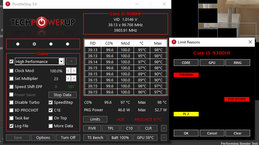

This is throttlestop after/during 10 minutes of cinebench. Scored 5036 points in multi-core (if it has any relevance)
Your CPU is thermal throttling because it is too hot. It is not a power limit throttling problem. Have you ever opened up your laptop to clean it out?
Thin and light laptops have marginal cooling. You are probably getting as much performance out of your laptop as you can get. Now that you have proven that you do not have a power limit throttling problem, you can reduce the power limits back to 45W or 40W or whatever you like. This will reduce maximum performance and your laptop will be more likely to power limit throttle as opposed to thermal throttle.
If you do not like throttling, buy a bigger and beefier laptop next time.
I had to lower my core undervolt to 125
I would have tried reducing the cache undervolt first. Set the cache to an offset of -120 mV. That might allow you to increase the core offset to -150 mV or more. It is almost always the cache undervolt setting that is responsible for blue screens.

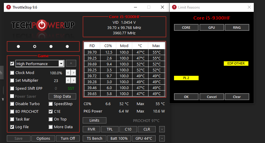

tripping on PL2
Some CPUs seem to be hyper sensitive and you will quickly see the PL2 box light up yellow soon after clearing it. This is not important. Watch for red boxes in Limit Reasons under the CORE column. That is what indicates that PL2 throttling is in progress. When you see that, look at the power consumption value that ThrottleStop reports. How does that compare to the power limits you have set in the TPL window?
Some laptops will limit the CPU to its 45W TDP value long term no matter what the power limits are set to in ThrottleStop. There is a third set of turbo power limits controlled by an embedded controller (EC) that some manufacturers use. ThrottleStop does not have access to the EC power limits. If these are set to 45W or less, there is nothing ThrottleStop can do about it.
