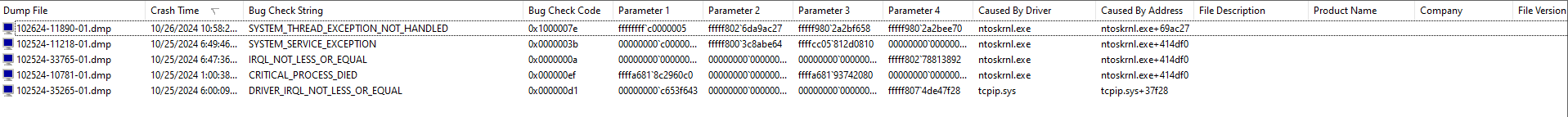

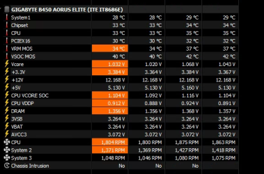

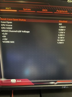

I just got these from a remote desktop session with him.
The only voltage I see that's unusual is the RAM voltage, 1.375v seems a bit high. Ideally you want to keep it at or below 1.3v. Some RAM kits state 1.35V but the Ryzen 2700/2700X is known for not liking 1.35+ on RAM. Try dropping the RAM voltage to 1.3V and run the RAM at 3200. Should end up stable at those settings. Everything else looks good.
I installed Blue Screen Viewer to try to get some dump reports. It appears to be generic crashing that normally pops up with unstable overclocking. I have turned off the XMP on the G.Skill RAM running it at 2133 now instead of 3000.

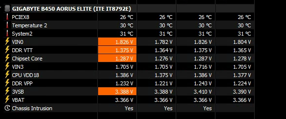

I have an older Corsair TX-750W power supply installed now as well. I haven't had any issues since turning off the XMP. Still testing and running different games/benchmarks on it. Even if it stays stable for now, with it not running XMP as it has for many years, I am inclined to believe that the CPU/MB have possibly degraded.

I will give dropping the clocks a try. It has been running a little over 3.5 years with that RAM in there. Only in the past couple of weeks has he started having issues.
