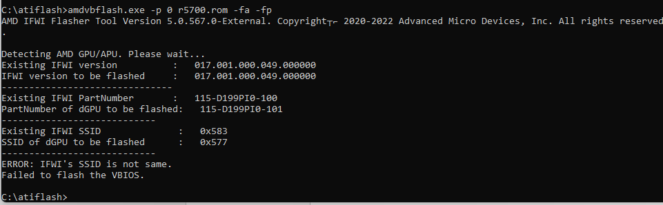

So i tried to flash my ASUS RX 5700 Dual Evo to XT but im running into this error on Command Prompt where it says Error: IFWI's SSID is not same.
I am running the latest AMDVBFlash/ATI ATIFlash v5.0.567 and i also ran the AMDVBFlashDriverInstaller.exe and installed the AMD Tools Driver. Im kinda stuck on this bit... any help would come in handy :)
Is there a specific XT vbios i need to flash for it to work?

Try 3.31
Update: Now ive installed v3.31 this shows up on command prompt ERROR: 0FL01
Am i probably flashing the wrong BIOS for my Asus RX 5700 Dual Evo? Cause im not sure and this is the BIOS im trying to flash..
Yes
Yup you cant flash a TUF to a dual evo
damn, so what bios can i flash, Reference BIOS maybe? Or non of these bios work with the Dual evo.

none of these bios worked unfortunately. And its still giving me this
You need to Force bios flashing with -f command also you need to unlock your bios first......
Something like this:
amdvbflash.exe -unlockrom 0
amdvbflash.exe -p -f 0 name.rom
But before you do this maybe you should try MorePowerTool and RedBiosEditor personally as I remember is better when you tweak/play with your original bios and then try it in MorePowerTool and see how that goes before you do the flashing .....I also assume that you know what are you doing.......GL

Unfortunately -f and -unlockrom 0 doesnt work on the latest amdvbflash version and eidairaman1 said on the forums that if you have rx 500 series (Polaris) thats the commands u wanna use but if u have rx 5000 - 7000 (Navi Series) then he recommends to use amdvbflash v3.31-5.0.567 but those two versions dont support -f and -unlockrom 0 commands anymore ;(
Well when I was flashing my previous GPU RX 5700 I was using some older version then and it was working perfectly fine I flashed more then dozen times always using those commands......
