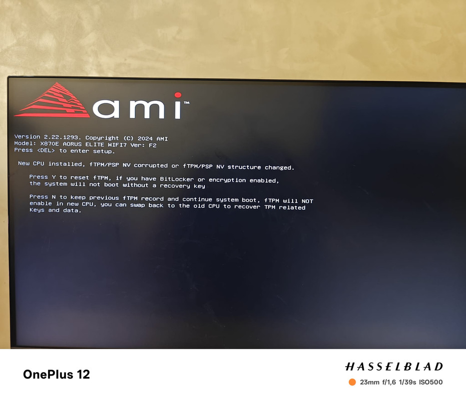

and I got this message:
I pressed something and usb booted for windows installation all this while debugger had led on some errors (00,d8/08,99,50 I mean random ones).

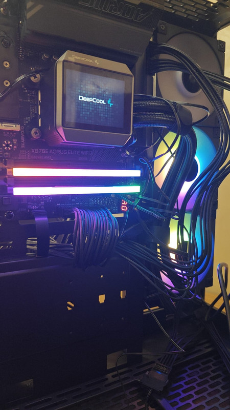

Nothing at first but after I reinstalled rams In position A2-B2 I got random codes and it booted into windows! I resetted into Bios and I have red led ram on mb and code 00.

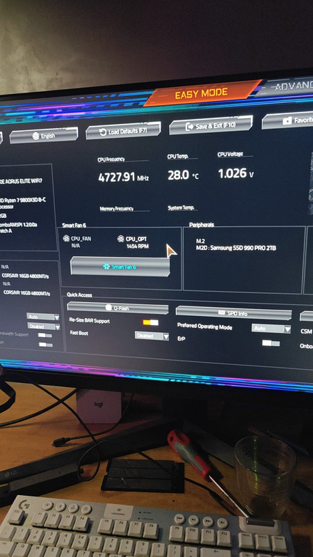

Got into Bios and enabled Expo1 to get rams to 6000mhz
When I get into windows red led on Dram motherboard goes off.

I noticed that chipset zone bottom right on mb it get really hot while doing nothing simply being on windows.
Aio screen says temp is 35°C
Aio has 2 fans with argb on but on the third one rgbs are off (all fan spinning smoothly) dunno maybe someting is loose
