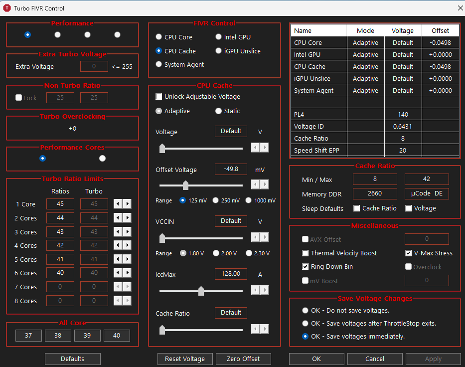

Post a screenshot of the FIVR window and TPL window so I can see your settings.
So I guess thermal paste or the heat sink was the problem like you said. I tried to flatten the heatsink by pulling hard from each side at the same time :) idk if it made any difference then I've found this article and tried that (never heard of tinting before)
now temp difference is like 6-7 degrees and overall temps dropped like 15. max temp was 81 at the ts bench without yellow or red error I've never saw my temp that low since when I bought it , it was always like 90-95 throttling. here is tpl and fivr

I would set the PP0 Power Limit to 0, press Apply and then clear the check mark out of the PP0 Power Limit box and press OK to save that. This power limit is not necessary.
I would check the MMIO Lock box since Intel CPUs do not need two separate sets of power limits. The MSR power limits are good enough.
I set Power Limit 4 to a value of 0. Just another power limit that is really not necessary.

You are welcome. I still enjoy seeing a success story like you have posted. :toast:
