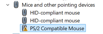

I noticed in the Device Manager that I have a PS/2 compatible mouse listed that has a, "This device cannot start" error message. I am going to disable that and see if it makes any difference.

I had a similar issue once too on my laptop. You probably have an Touchpad connected via I2C and not PS/2. But many keyboards are connected via PS/2.
You can check that when you select the device with yellow triangle and go to View -> device by connection at the top. Then you get the proper tree view.
At the PS/2 device right click and select "uninstall device". Select the checkbox for removing driver too. You don't need any third party driver for mouse, keyboard and touchpad anymore.
