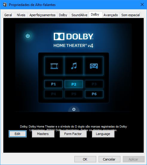

If Dolby PCEE4 is available on the optical output, test with Dolby Digital Live or DTS Interactive and you will realize that Dolby PCEE4 processes these audio signals.
Latest drivers work fine also for me. It was something with one of my optical cables not being connected ok....

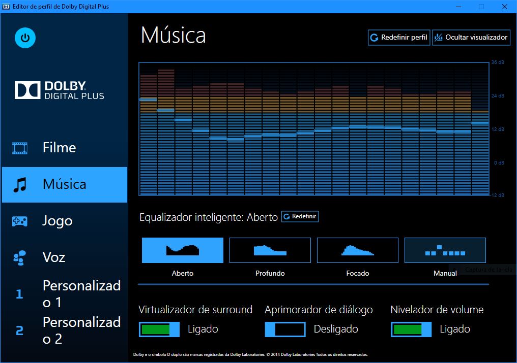

Here I have already changed Dolby PCEE4 (DAA v2, DHT v4) through DS1 (Dolby Digital Plus) in all endpoints. I'm making some more adjustments to the driver. I'll post more soon.
Here is the proof image:
