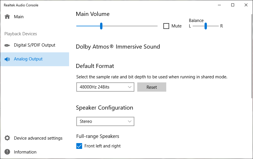

ever since the "fixed" 8996 or 9003 version, installing Dolby Atmos from the DCH modded driver pack along with Realtek Audio Console and the Realtek EQ & environment options are gone and the "Dolby Atmos Immersive Sound" option appears instead (in this pic)
I think this behavior is by design (aka. expected behavior) as Realtek decided to "integrate" the Dolby Atmos sound option in here (when installing Dolby Atmos) and block out the Realtek Sound Effect options (like EQ & environment) since v1.16.228.0. the last version of Realtek Audio Console to "not" do this is 1.15.227.0 where the EQ & other Realtek audio sound effect options remain available while having Dolby Atmos installed. I had to remove the latest Realtek Audio Console app and manually install an older version like 1.15.227.0 just to get the Realtek EQ & environment sound options back
