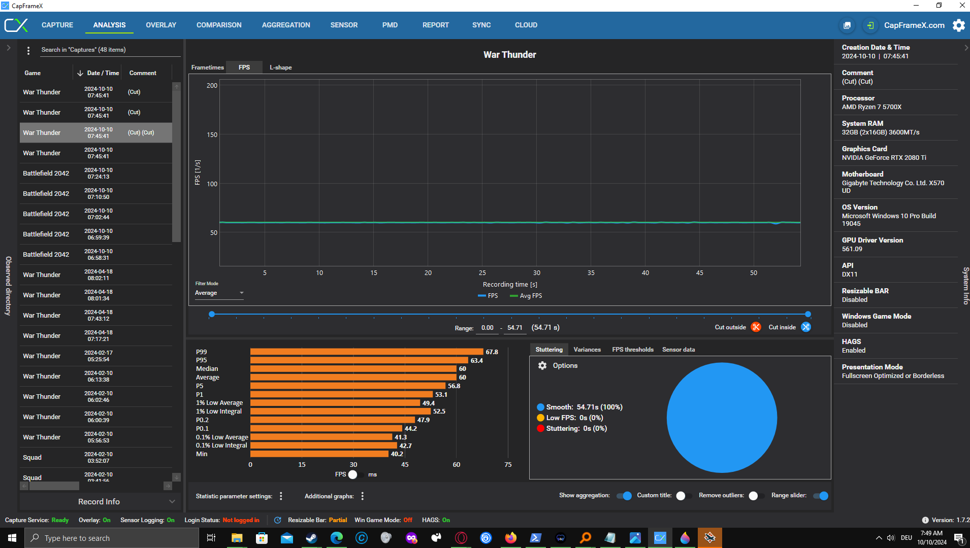

cap frame x from a few minutes of 64 player bf2024 mp game vsync 60fps/60hz rtss cap 59.97 pre rendered frame 1 dlss 720p->1080p ultra / high quality / two monitor w. 100+ browser tabs open youtube video playback:
war thunder benchmark / offline, note fps are way more stable in single player scenarios:

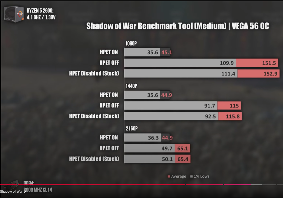

not only it seems that for intel more than amd hpet *can* be pretty much equal and ok in a lot of games - but also that there are issues with hpet in itself and probably also with synchronization of timers and conversion of different timers / timer settings between the os and the game / app because the game engine uses a specific timer that must first be transformed.
the fact that hpet on works great with amd should actually make them pretty good for gaming and even profits again with it off while for intel it would be recommended to have it always turn it off.
the charts come from this article:​
- "Given that the difference between the two sets of data is related to the timer, one could postulate that the more granular the timer, the more the effect it can have: on both of our systems, the QPC timer is set for 3.61 MHz as a baseline, but the HPET frequencies are quite different. The AMD system has a HPET timer at 14.32 MHz (~4x), while the Intel system has a HPET timer at 24.00 MHz (~6.6x). It is clear that the higher granularity of the Intel timer is causing substantially more pipeline delays – moving from a tick-to-tick delay of 277 nanoseconds to 70 nanoseconds to 41.7 nanoseconds is crossing the boundary from being slower than a CPU-to-DRAM access to almost encroaching on a CPU-to-L3 cache access, which could be one of the reasons for the results we are seeing, along with the nature of how the HPET timer works.
There is also another aspect to gaming that does not appear with standard CPU tests: depending on how the engine is programmed, some game developers like to keep track of a lot of the functions in flight in order to either adjust features on the fly, or for internal metrics. For anyone that has worked extensively on a debug mode and had to churn through the output, it is basically this. If a title had shipped with a number of those internal metrics still running in the background, this is exactly the sort of issue that having HPET enabled could stumble upon - if there is a timing mismatch (based on the way HPET works) and delays are introduced due to these mismatches, it could easily slow down the system and reduce the frame rate."​
i argue that the hpet issues are mainly due to it being bugged and not properly implemented yet. it needs more work and attention and performance and compatibility should increase with the future by new hardware and software and bios updates etc as well, too. in the end it seems like it all depends on the engine for the greatest part. the higher the resolution the smaller the difference becomes in some cases and this can have several reasons where maybe one of it is that things become a more gpu bound scenario. this is also a performance tip for pcs with strong gpus but weak cpus (max out game gfx and res).

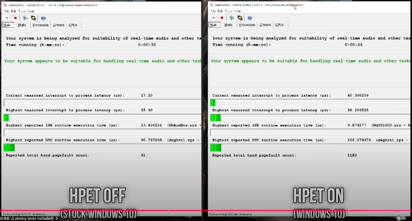

author of timer bench mentions hpet as best choice for gaming:
this channel does really good benchmarking with a lot of the settings and tweaks that have been mentioned in the thread and much more:
