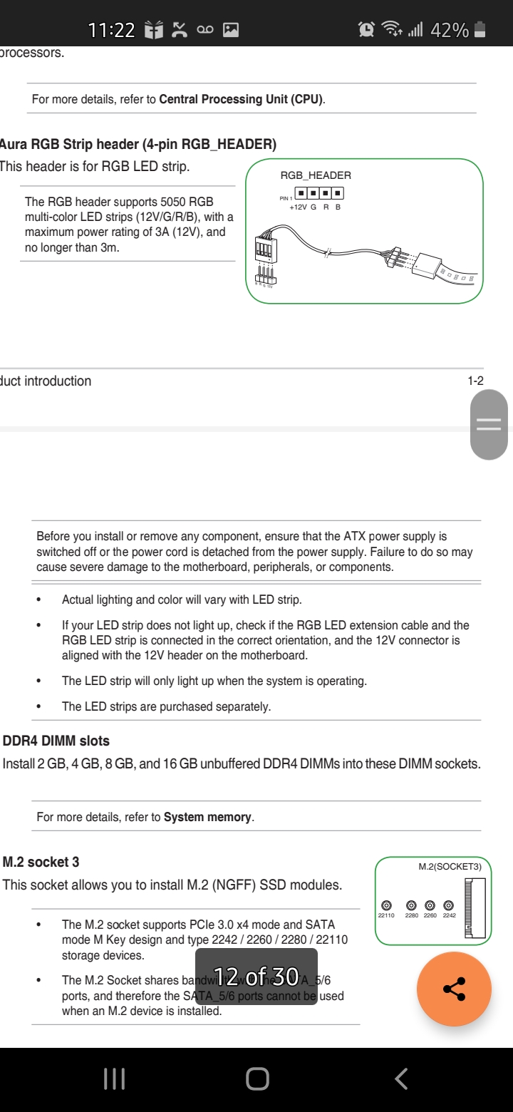

1 aurasync header
It seems the motherboard header is only for led strips, and the manual doesn't go in depth to control aurasync functions through the bios.
I see my bad.
Yeah thank you, it looks like it should work

1 aurasync header
View attachment 221200View attachment 221202View attachment 221203View attachment 221204
So this means what exactly?

Yep 12v 3xground that adapter I posted should convert it for use with the fans seems weird why a b450 board didn't come with 5v.
It means you would either need fans that have a separate rgb line or an adapter @ThaiTaffy suggested.
And learn how to use the bios on the motherboard.
Otherwise you would need a pricier AM4 motherboard

Not sure how much it is there where you guys are but the $10 adapter seems the best option :D
