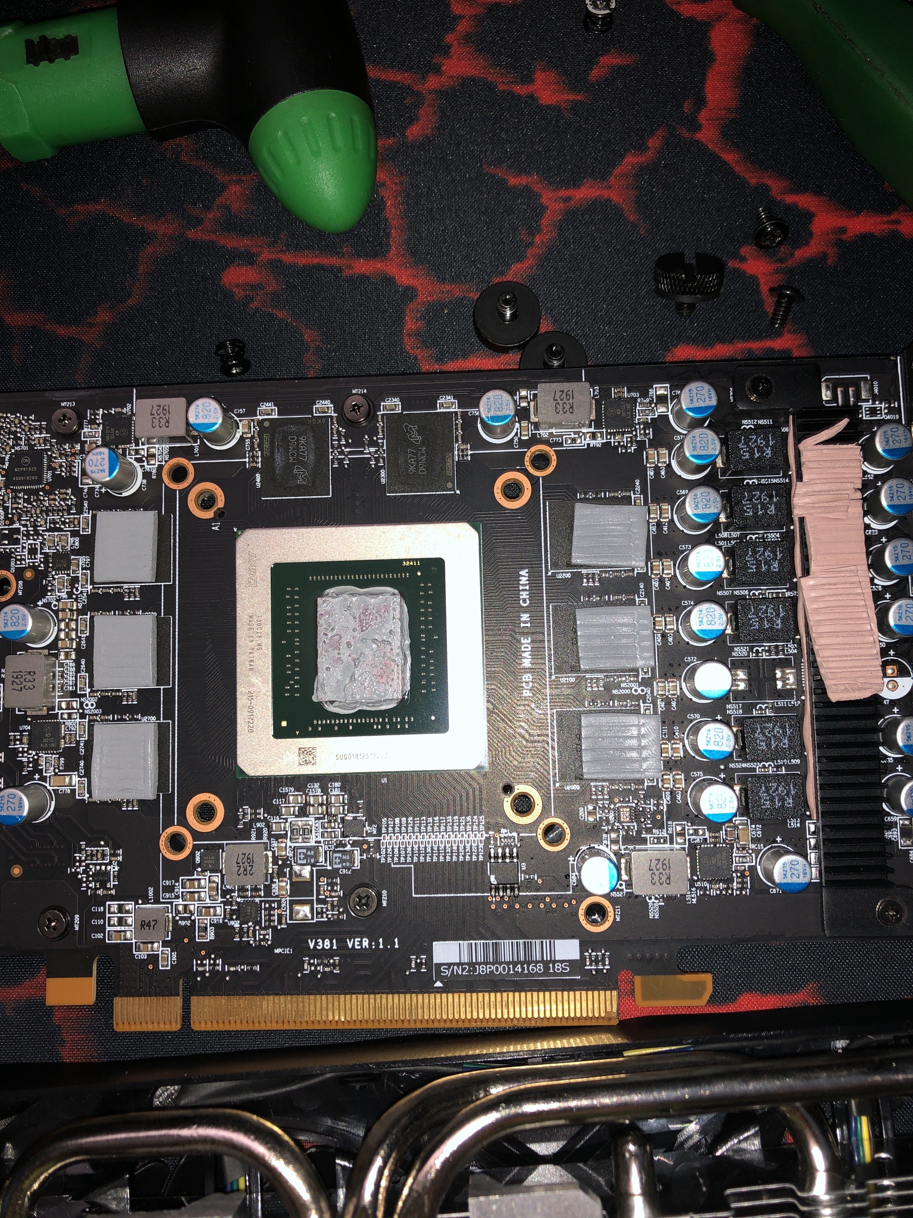

Does the gpu need to be plugged in? or what? there’s no info on that post on anything. and where would my bios chip be?
Directly above the SN # over the pci-e fingers.
it is basically rectangular in shape with 8 contact legs and a dot in one corner to indicate 1.
ok does the gpu have to be in the pc and does the pc have to be turned on?
Short these 2 pins somehow (paper clip, small cable, solder)
Then put the heatsink on and plug it back in the computer.
It might work and you could flash it back.
If you can't do it, you can take it to a technician or order CH341A flash programmer kit.
you need to use both ends of the paper clip to short those terminals so unfold that paper clip all the way bend it in half and touch the two pins with either ends of the paper clip
