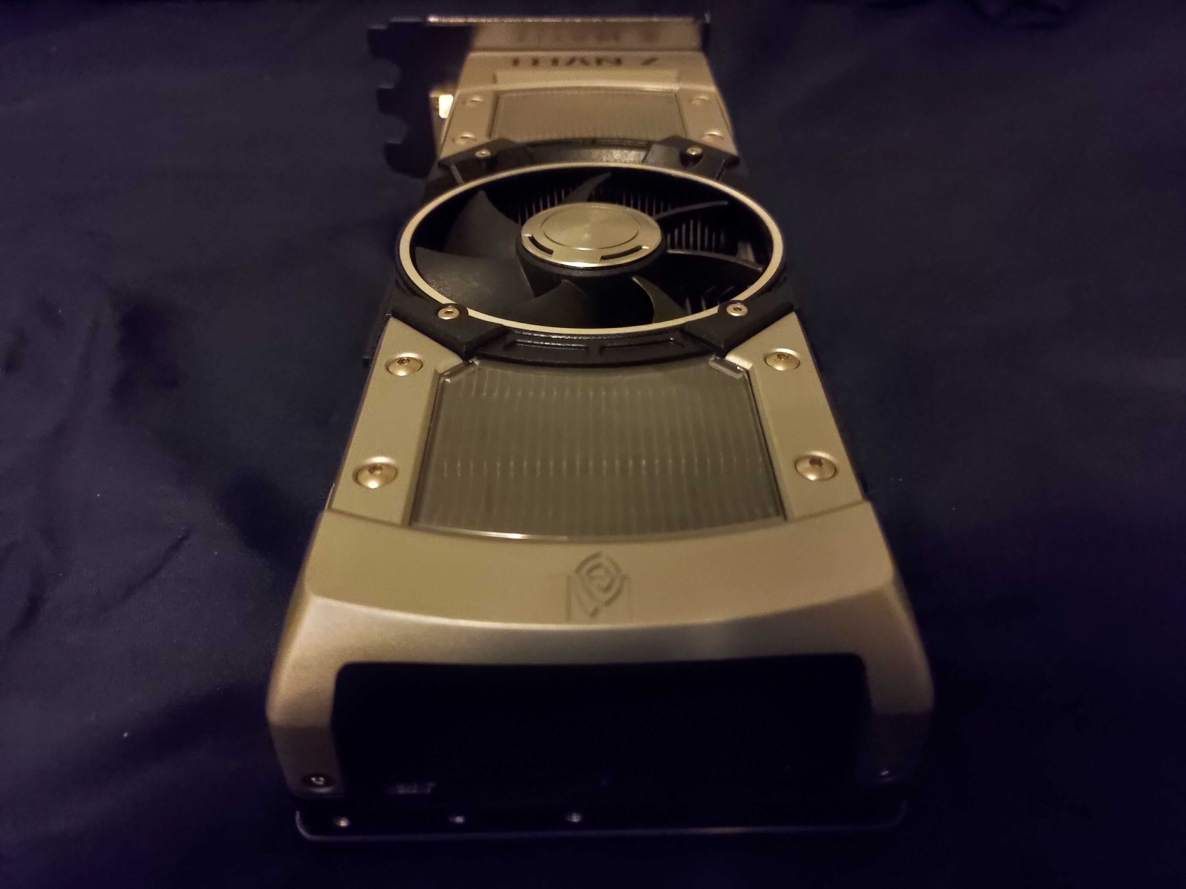

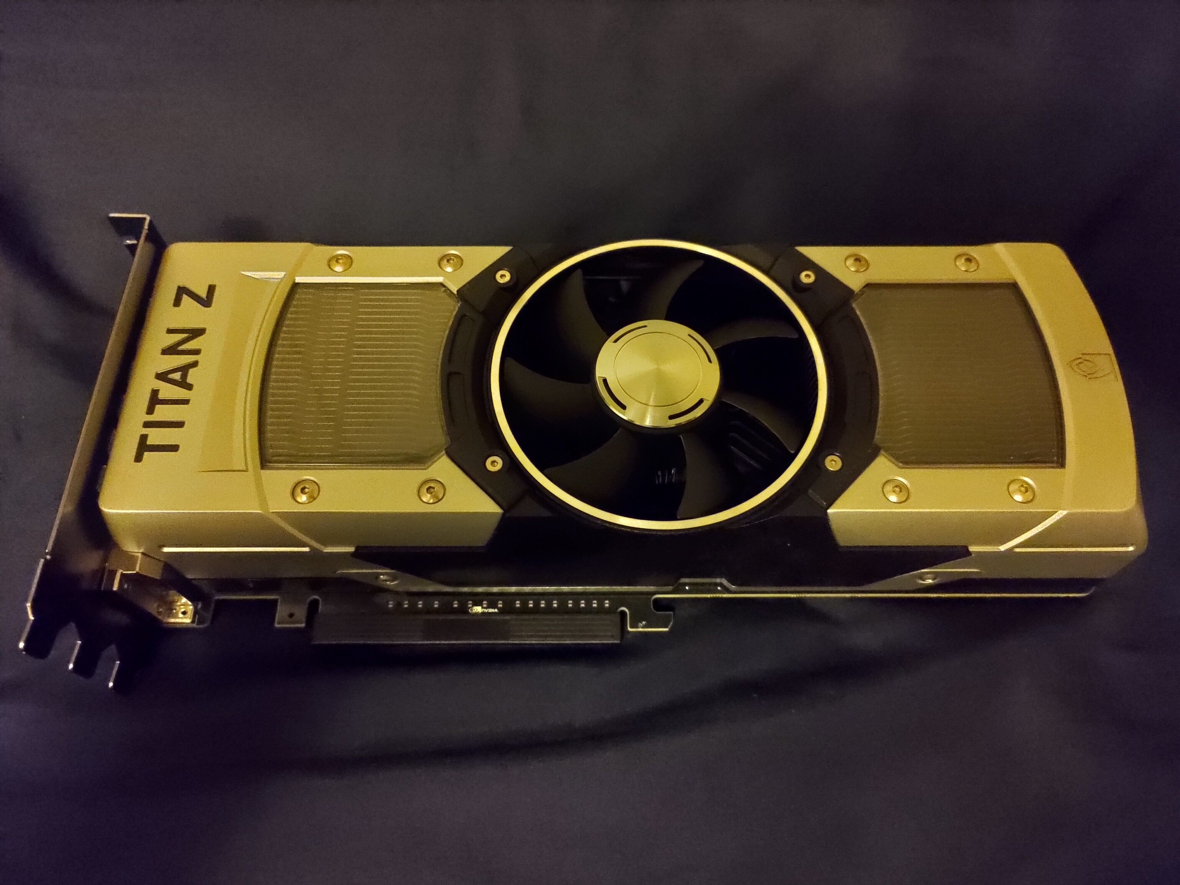

Titan Z time!
On a less exciting note, Docker time!
Last note for the night, I've decided to replace the GRID K520 with the GTX Titan Z. Need this to work in Linux and macOS, while also being supported in Sunshine when the time comes. Can't currently do that with the GRID K520 for some reason. Need to work that out later, when the rest of the project has caught up...
