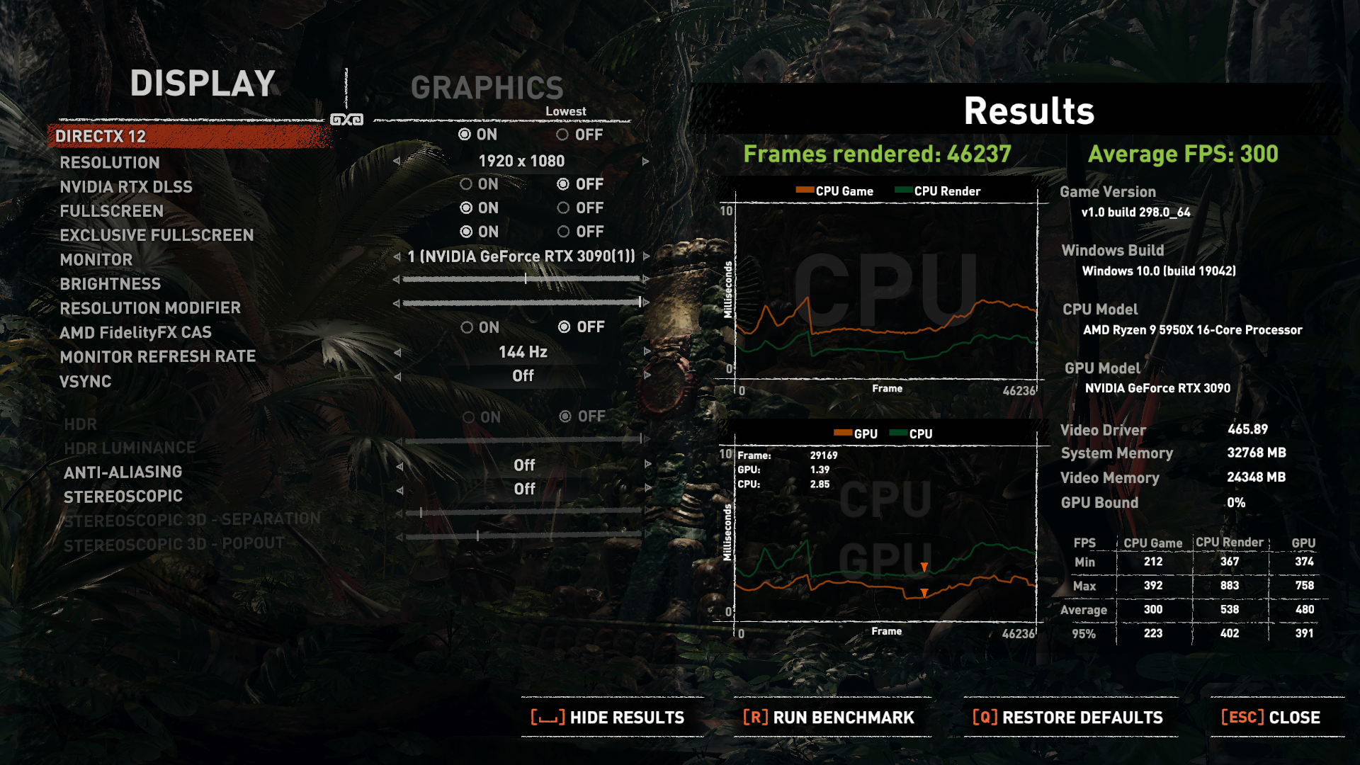

And speaking of Cpu performance in SOTR, whatever i did, the cpu stats basically remain the same, when there was a Fps increase, the section that increased was the Gpu section, i wonder if thats a difference of architectures since you have a Amd Nvidia combo, i have a Amd Amd combo, so the game engine might behave differently.

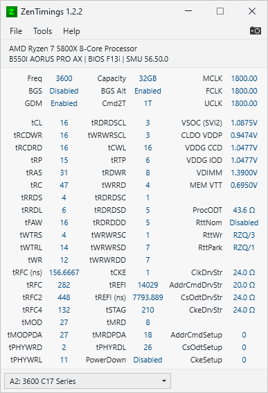

Thanks for the tip. Here's what I got with your suggestion. I'm heavily thermal limited as the rig is in an ITX case.
here's my timings on the same rig with a ryzen 3600. I can't do it with my 5800x.
3% more fps :) Further suggestions: twtrl 12 or 10, trrdl 4, twrrd 1. If you can run voltage higher on the ram you can tighten further. With 1.45V you can try 15-15-15-14-30 44 trc and 264 trfc. That should give you a good boost. You might be able to run cl14, but that depends on how good binned your ram is.
If you have the same ram on the 3600 try trp 15, tras 33, trc 48, trfc 288, trrds 4, trrdl 6, tfaw 16, twr 12, trtp 6, that mught work at 1.4V or a bit higher.
