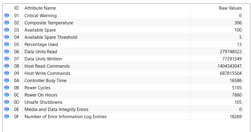

Cool, can you switch the raw values to decimal? It makes it a lot easier to read and notice values changing (no leading 0's for starters). You can do that by going to Function -> Advanced Feature -> Raw Values -> 10[DEC]
ID Values I think that may be of most interest are probably 0A, 0E, and 0F.
Just keep doing whatever you normally do and run CrystalDiskInfo every so often. It will track the values changing (if they change), and you can use the Function->Graph feature to see how much they changed over time.
I changed it to 10[DEC] as you said. Btw i added some launch commands to CS2 and enabled MSAA 2X and it became much more stable. I didnt notice *important* shutter. Sometimes it just happens when the round ends but its ok for now. Here is a result of match i played now.
Should i send the values now for the checking it later?
Up to you - could put them in the thread for reference.
If you keep CrystalDiskInfo running / make it run at startup it will keep a log of the values and if/when they change over time.
0F which is 'Number of Error Information Log Entries' may increase over time normally - unfortunately that attribute logs if the drive gets sent any invalid requests as well as if there are actual drive errors.
0A which is 'Controller Busy Time' contains the amount of time the controller is busy with I/O commands - a drive that's struggling to read/write data properly may end up spending a lot of time 'busy'. From what I can tell this value is in minutes so really, with a PCIe v3 interface and normal desktop usage this value should increment pretty slowly.

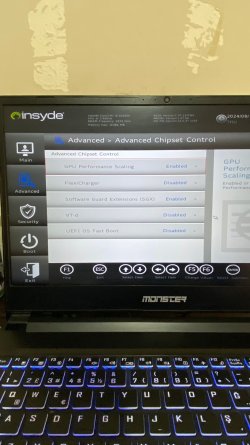

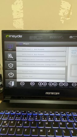

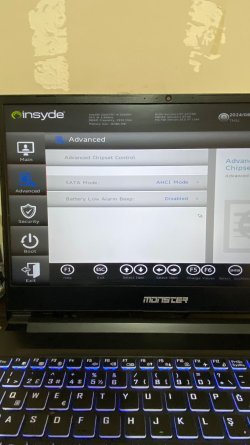

Can you post some screenshots of what your settings are in the BIOS, specifically under the sections:
USB Configuration, Chipset Configuration, Type C support, and CPU Configuration
Sadly the screenshot you sent is unlocked/modded bios.
