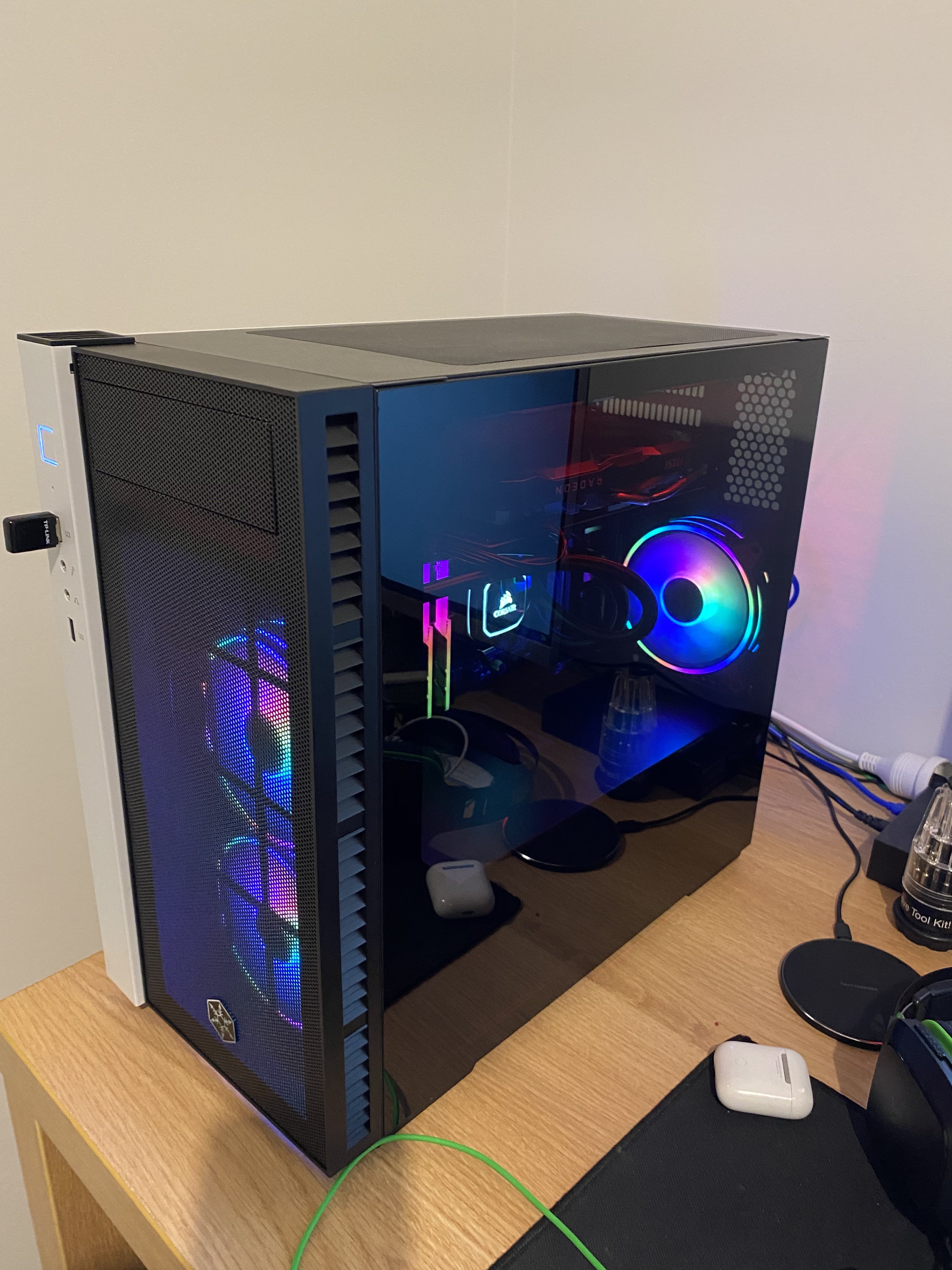

Wanted to share this with you all, I took the plunge and bought this case also! I get 41 degrees CPU and 56 degrees GPU when gaming! The concepts works and works very very well! Enjoy the pics!
specs: 2700 Ryzen / 5600xt / 16GB Ram
