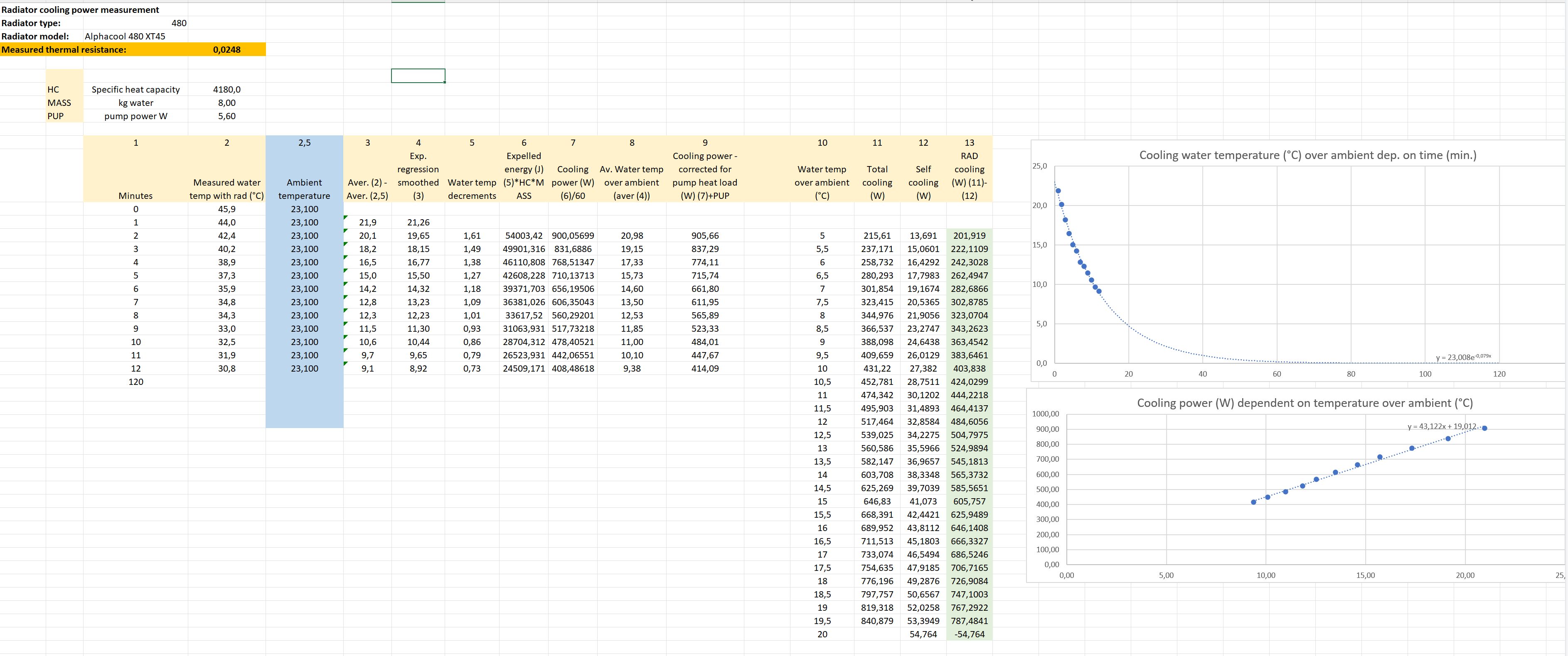

Alphacool NexXxoS ST30
Alphacool NexXxoS HPE-30
Alphacool NexXxoS HPE-30 PUSH PULL
Alphacool NexXxoS XT45
Alphacool NexXxoS UT60
Alphacool NexXxoS UT60 PUSH PULL

The cooling power in results table is calculated from the thermal resistance number written in the table.
The measurement is simple: when the ambient is for example 23°C and water temperature in minute 6 is 35°C and in minute 7 is 33°C, the average is 34. Temperature delta in this time period was 11°C - this is the first input of the measurement. Using the specific heat of water, mass of water and the difference of 2°C, I get expelled energy in this time period (66880 J), which I then divide by the number of seconds in the time interval and get cooling power in watts - 1115 W. Using these two numbers I get the thermal resistance (0,0099).
I perform whole series of these measurements and that way I am getting more reliable result with my imprecise temperature measuring method. I am smoothing out the water temperature measuremens with regression function. How I mentioned earlier, the biggest weakness of my measurement now is imprecise measurement od ambient air temperature.

This setup would bring some improvement to what I do, but I would need to buy more stuff than just one datalogging thermometer that I need.
I just bought one.
I will need to revise my calculation, improve physical measurement (I also have a problem that the inlet and outlet air are not separated enough, it would not harm if the bucket was a bit more isolated and covered, although I am correcting the measurement for the bucket self cooling as is).
I will then need to redo all the measurements.
Another problem is that now I have only one current 420 EK rad, 4 Alphacool 480 rads (current) and one older 420 rad. Every other rad I measured has been returned to the retailers. Retailers do not like me much...
In the meantime Excel gurus can tell me, where do I find the regression function parameters, so that I do not need to read them and input them in the sheet manually.
