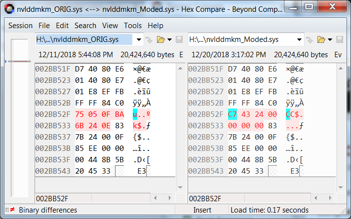

...A valid hypothesis would be if you either made a mistake while hex editing or if you're editing a version other than 417.35...
I don't think I fat fingered the hex-edit. I attached a Beyond Compare hex-compare of my changes.
I see. Again, just to make sure it's not something trivial, if you replace the .sys file (switch between original and patched) and restart, the NVIDIA control panel will show up only if it's the original correct? Are you booting with testmode? (Do you have the watermark on the right bottom corner when you're using the patched driver?)

I use 417.35
i HEX edited sys file succesfuly and create cert, but not show SLI option.
I fixed path in install.cmd
run us admin

I use this offset:
417.35
00000000002BB52F: 75 C7
00000000002BB530: 05 43
00000000002BB531: 0F 24
00000000002BB532: BA 00
00000000002BB533: 6B 00
00000000002BB534: 24 00
00000000002BB535: 0E 00
why not working?

sys file not oreginal. new different size in :
Yes i run install.cmd in safe mode
now checked signed file in hexedit
0x2bb52f C7 43 27 00 00 00 00
is correct
Isn't it supposed to be
0x2bb52f C7 43 24 00 00 00 00
sry 24
this is signed file. I accidentally wrote 27, the file is in 24

This all looks correct.
Did you do a file search for nvlddmkm.sys all over C:\WINDOWS\System32\DriverStore\FileRepository to make sure you have no duplicates?
Does the secondary card point to the same driver location in Device Manager as the primary one?

From what I can tell, everything looks correct: You made a copy of nvlddmkm.sys, patched it and installed it in Safe Mode as admin using Install.cmd, modified with the correct paths. The file was copied and the certificate installed successfully.
Still it doesn't seem to work.
To me this leaves two options:
  1. The 'new' way of patching (for the 4xx driver generation) has had only some few installs so far; it's not been tested thoroughly. So while it does bypass some important checks, it might not cover all situations, for example missing bypassing the check for a SLI bridge. If you have one, you might try using a SLI bridge. But there's no guarantee that this is actually the culprit here.
  2. Falling back to the proven old method, using DSLIA 1.7.1 and 388.71
