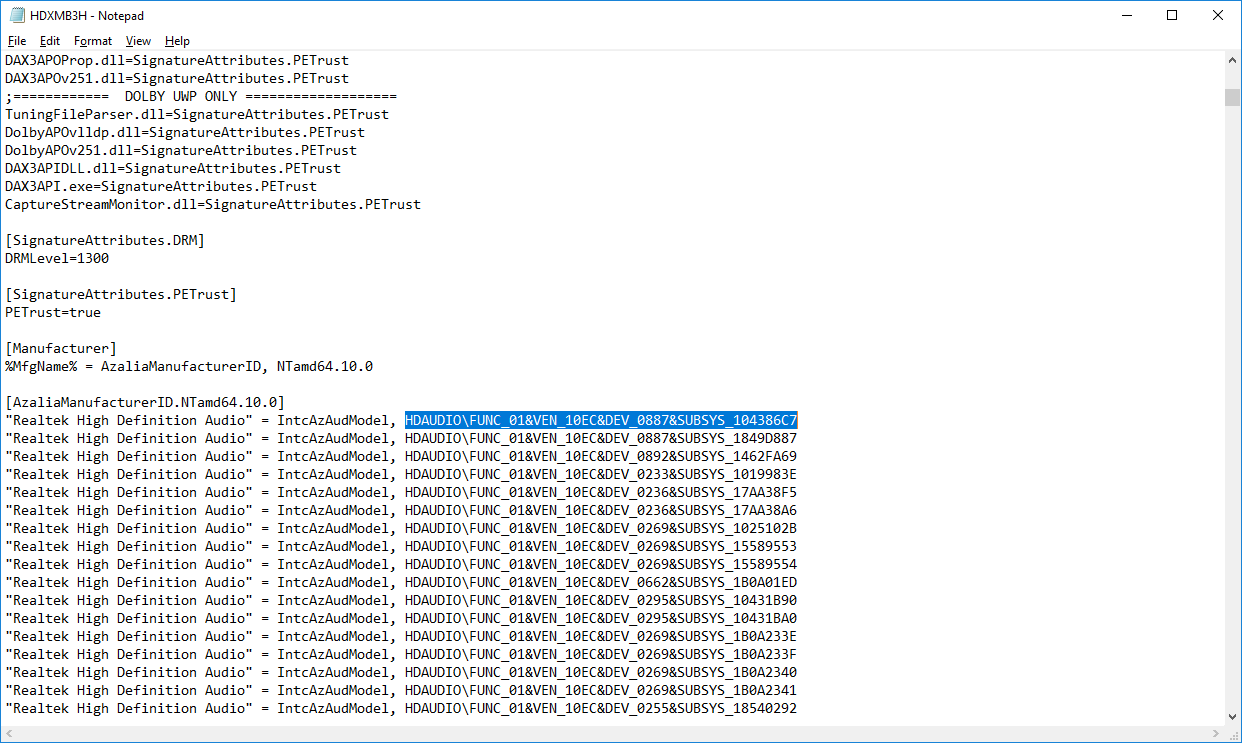

If that is setup.exe error, try placing ur hardware ids in HDXMB3H.inf file. (may be HDXRT or HDXRT4.inf) just search for [AzaliaManufacturerID.NTamd64.10.0] line.
