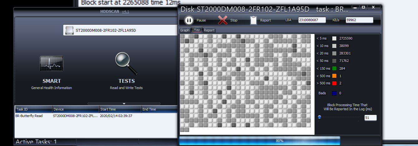

After i deciding to RMA my Toshiba....just got another problem with my 1 months old Seagate Barracuda 2TB, the problem almost the same with the Toshiba ext hdd, while i rendering the video project, the Seagate hdd disconnects and reconnect randomly....sigh
Now, do you guys thinks do i have PSU problem ? (unsufficient power)
Sorry for the late respond guys......

Is it a bad sign for my Seagate hdd ?
