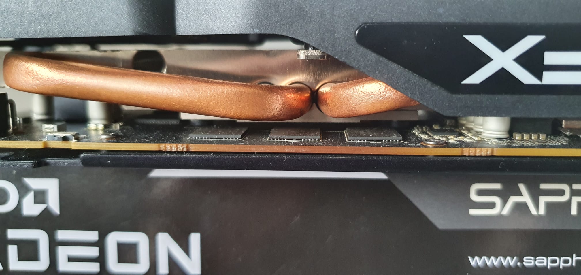

BTW, as @eidairaman1 said earlier, i would add at least one more good cooler in your pc case, cause you will need better air flow.
I do not remember if your card have all memory chips covered by thermal pads.
At Asus there are several model and XFX 470 also have some models w/o thermal pads on all memory chips.
Since you modded now your card , you will get higher temps.
So be careful.
Below you can see what i mean :
