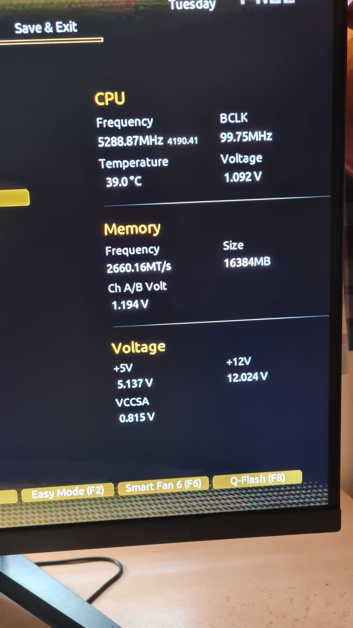

Hello, I recently bought a new desktop PC with a CPU i7 13700K and a motherboard Gigabyte B760M DS3H DDR4. I should be able to undervolt but as you will see in the screenshots I'll share, the changes I have in Throttlestop are not working, Offset value stays at 0 despite having the offset voltage at -125 MV. I even got into BIOS to manually undervolt the CPU but it's just not working, I don't know if there is an Undervolt Protection option which I had not found. I searched in reddit and I even change. I took some screenshots of the BIOS settings as well. I use Windows 11 and I even have VBS turned off, I don't know if I have to turn off something else, temps are not a problem since it's a new desktop (60-70ºC while playing) but I would still like to use this feature.
EDIT: Using Gigabyte Control Center, it says that Undervolt Protection is enabled, I don't know what more to turn off, I already disabled Intel Virtualization.

ThrottleStop shows that Undervolt Protection is enabled. That means any undervolt request will be ignored by the CPU.
Some Asus B760 motherboards have an option in the BIOS so you can use the early 0x104 microcode. Look for an option like that in your BIOS. If you cannot find this option in the BIOS you are using, try updating the BIOS. It might be in the latest beta version.

I have read about the microcode thing, I have the latest BIOS update and I can't find that option, I have tried to change the BIOS to the one that shows the microcode option but it doesn't seem to work, I cannot flash it... guess I'm screwed then.
Wait, I think I found it, not sure if it is this option
EDIT: Undervolt works now but the PC keeps restarting over and over..

That is the option!
Set it to 0x104 and when you run ThrottleStop, the FIVR window should not show Undervolt Protection anymore.
ThrottleStop should also show that you are using the early microcode 104 instead of 115 that your previous screenshot showed.
