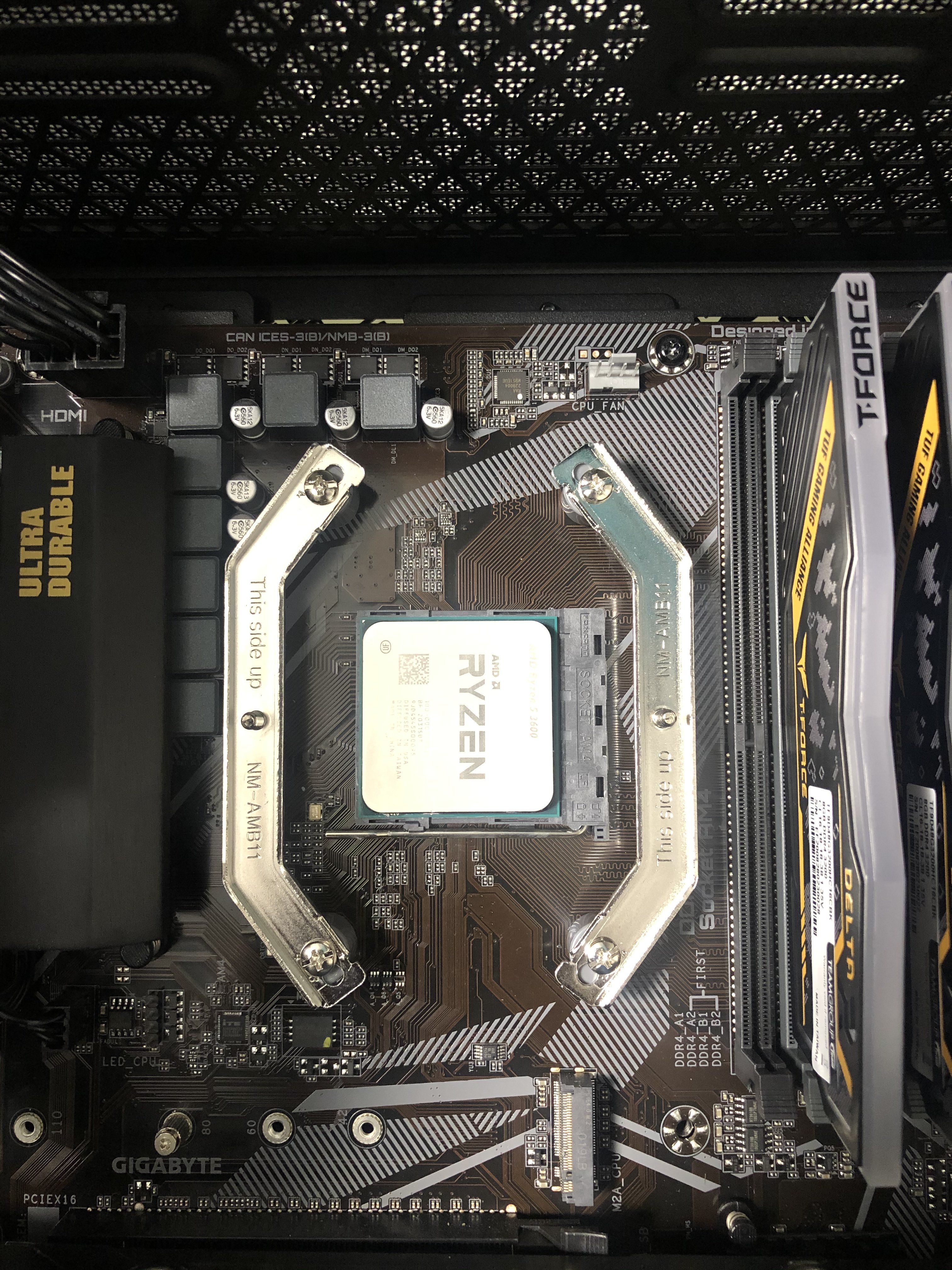

I sent proof of purchase 24 hours ago, but I have not been answered yet, so I used the AM4 kit that comes with the U12S. The only way to install the cooler is vertically (with the NM-AMB11).
I have ran Cinebench and my max temp reached 71 degrees. When I had the stock cooler on previously, I was hitting 90degrees. Does it sound ok?
R5 3600 - 4.3Ghz, 1.25V max

A 19º C improvement is quite good, IMO.
I'd shift that bottom fan to the top and make it pull/pull cause it looks like it's getting strangled for fresh air the way it is now with it so close to the rear of you GPU's back plate
I think i would as well
A 3600 at 4.3ghz. You should be running a decent AIO (all in one) liquid cooling solution. Usually anything over about 67 or 68c temps will cause a Ryzen to start throttling down.
