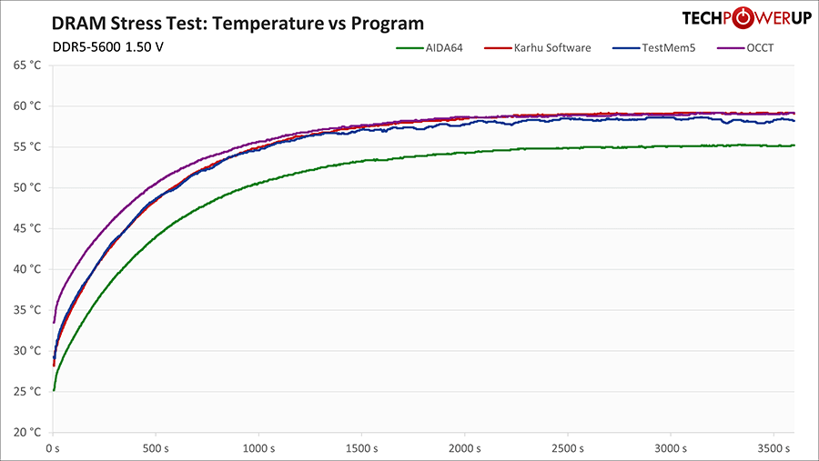

TM5 will get your ram hot, trust me.
Yep. 60c isn't bad. Depending on the frequency and timings you can get errors from 38c to 80s. Just depends on what the setup is.
Thanks
I think I screwed up a few hours ago. I had to redo all the mainboard settingsm as msi does not allow import of older uefi saved settings. I think around 43°C-45°C I got errors.
The only explanation to myself is the RAM temperature. I set the fan to 0% and forgot about them.
I strongly believe RAM temperature is very important on AM5 with DDR5.
