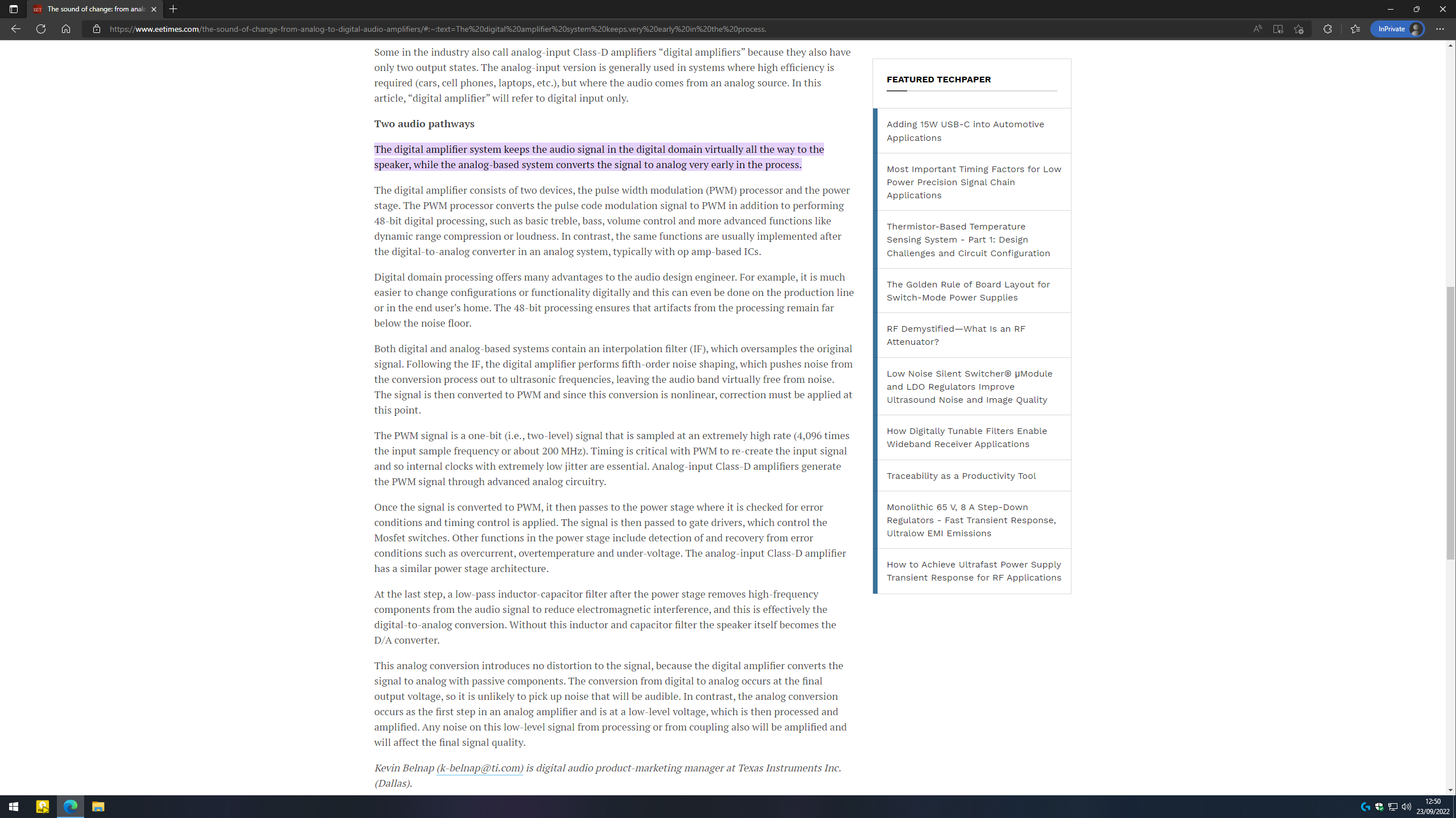

Stop being rude both of you. Not achieving better speakers. Also the Logitech Z906 is Class D, makes me wonder if it has a DAC at all (maybe for headphones).
The power stage needs improvements, 10% THD at 500w RMS is high, 0.1% THD at 500w RMS would be a massive upgrade.
However, device waves are produced via power, whereas for example talking, does use energy, but not electricity to produce the waves.
Exactly. That is why I said above sound is energy. In terms of voice, it is the energy produced by air being expelled through muscle action across our vocal cords, causing them to vibrate.
Also not to sound offensive but its not logical to convert digital to power early in the system, you want conversion at the speaker.
Not sure who that might offend. It does not me because that makes perfect sense. In fact, because moving and storing (and even manipulating) digital information consumes so little power (and space), that is one reason (out of many) digital has proliferated over analog.
