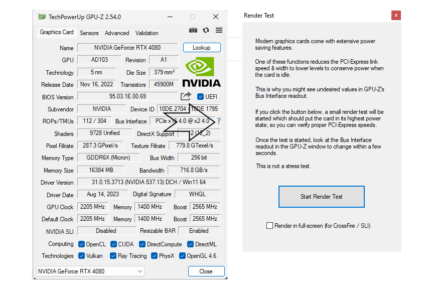

Wrong PCI Express in GPU-Z
i7 13700k

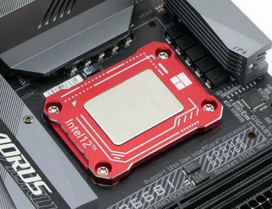

You probably also would wanna install the correction bracket. They cost about 5 bucks and solve the epic fail geometry issue.
I already have this accessory installed on my PC.

It might be worth checking what CPU-Z is showing. The Mainboard tab of CPU-Z should show this for your motherboard (source: TechPowerUp)
Going back to the original GPU-Z screenshot if you click on the Question Mark at the end of the section you should see this
So I think the explanation for the @ x2 4.0 is PCI Express Power Management at work while the graphics card is in idle mode. There is a setting in your BIOS that controls this, and it is set by default to Enabled. If you go to the Advanced section of the BIOS and then Advanced ->Platform Misc Configuration->PCI Express Native Power Management, set it to Disabled rather than Enabled. Save the setting and reboot, and GPU-Z should then show @ x16 4.0. Or run the Render Test and if that shows the same thing it is working as designed and you can leave it as it is.

I still think this could be a power management settings issue. The other thing you could check is Power Options in the Control Panel - Change plan settings->Change Advanced Power should bring up an Advanced Settings tab. There is a PCI Express->Link State Power Management setting. This can be set to Off, Moderate Power Savings or Maximum Power Savings. What is your setting, and does changing it to Off make any difference? There is also the BIOS option mentioned earlier.

It's clear that GPU-Z, CPU-Z and HWInfo64 are all displaying this x2 link width. But is it actually affecting gaming performance? If you have not already done so using Unigine Superposition with one of the preset benchmarks would show if gaming performance is about where it should be or not.
