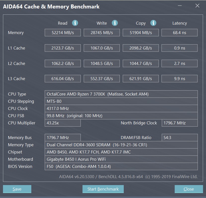

That said, he has a lot of tweaking to do, as this is what I get, admittedly at higher clocks, but with worse timings.
@ecopsorn Here's a result for 3600 16-19-21 on a single chiplet CPU like your own. Your 3600 16-16-16-36 kit should have far better latency than the 70ns showing you've posted. Read, write and copy are roughly where they should be, though very slightly on the low side, considering the Royal is B-die with good timings.
3900X takes a slight hit to AIDA latency due to two chiplets, but yours is a 3800X and has no excuse. Go into BIOS and find Power Down Mode for the memory (either under the memory section or some overclocking menu) and make sure it's disabled.
