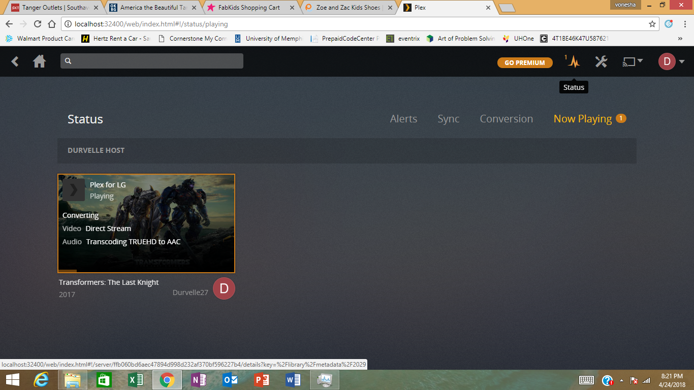

So i couldn't pull logs but i screen shoted this
As seen on the Xbox One X its transcoding both the Audio and Video
on the LG TV its directly streaming the video but transcoding the Audio
even the audio transcoding is weird as my HT supports Dolby Digital

And there's the problem... mkv (≤2160p) h.264 is not supported. I verified myself. My mp4 4K h.264 is just a green video on the Xbox One S. Pathetic. The Xbox One has enough GPU power to decode it yet for some reason, Microsoft prohibits it.
I suspect it is downsampling it instead of actually transcoding it (because h.264 to h.264). Either way, transcoding 4K video is a bad idea.

"H.264/MPEG-4 AVC" it supports it, just not at 4K or greater resolutions. Plex's list is accurate. Xbox One S only supports 4K HEVC or MPEG4 (not h.264). Xbox One X also adds support for 4K VP9.
I'm thinking the best solution is to convert it from h.264 to HEVC. HEVC is what ATSC 3.0 is moving towards anyway.
