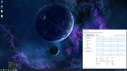

Interesting that it spreads the load out so much - i would have thought it would have wanted to keep the load on a single ccx. But impressive fps ! I wonder how it would look like if you used that cyberpunk fix aswell.

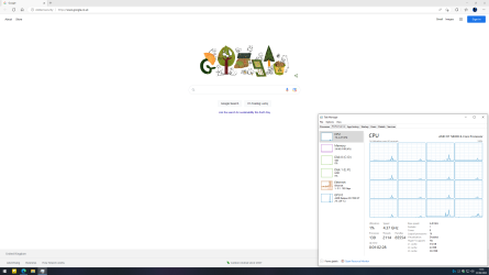

Just opening MS Edge hits all cores with my 5800X on Win10, cant say its perfectly even, but mostly.
I am also playing music which populates 4 of them.
