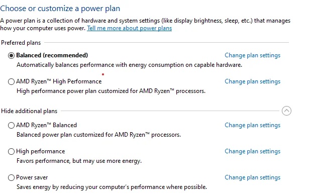

@Dragam1337, I just looked through the registry quickly, I suggest you backup Windows so you can fully restore.
You will need to Google what to change, but I guess you might be able to fix the problem (not sure).
Computer\HKEY_LOCAL_MACHINE\SYSTEM\CurrentControlSet\Control\Power\PowerSettings
Else try and find a suitable power profile (.pow) file, or make your own?
