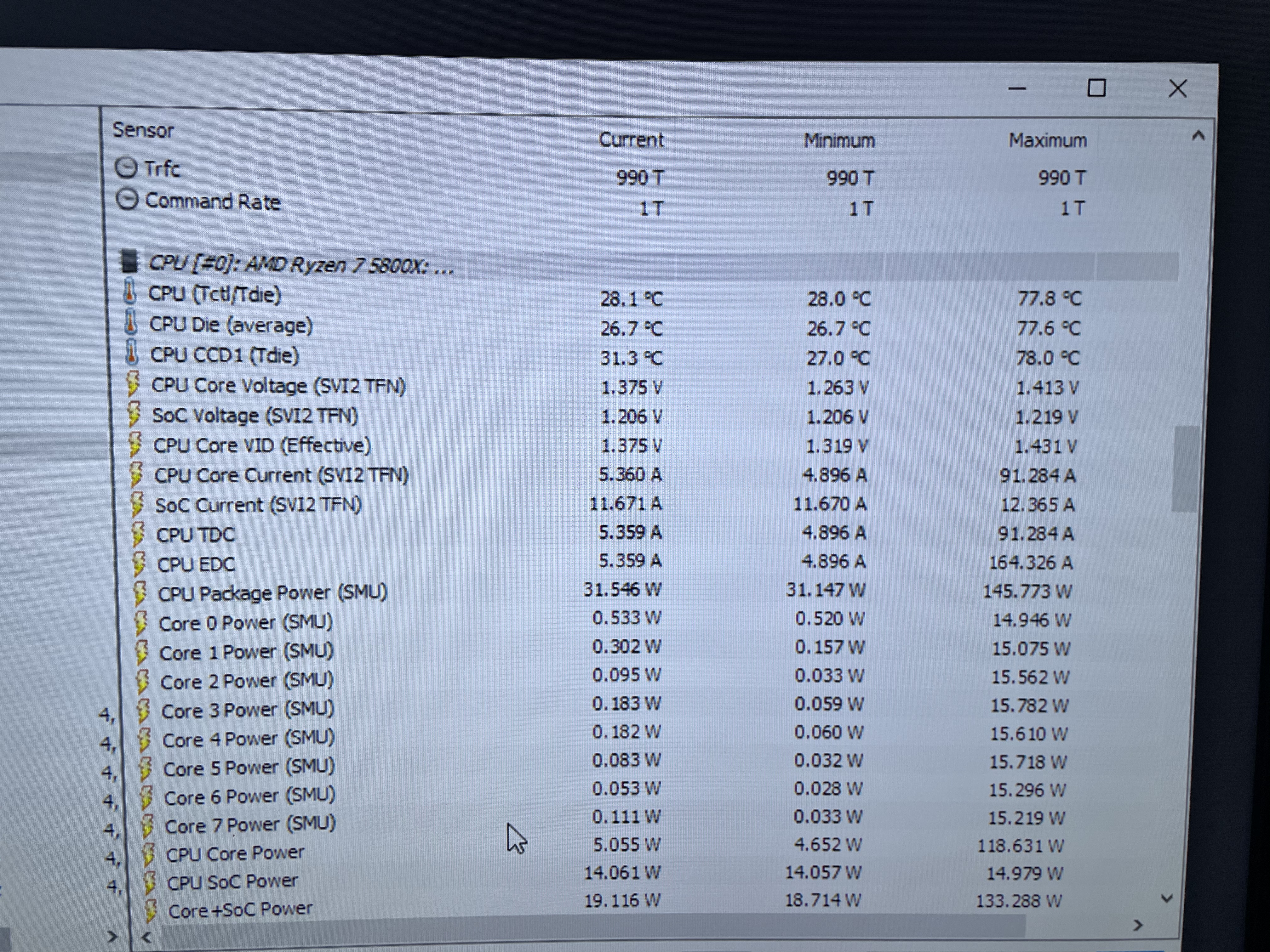

Those VIDs are just requests as we already said many times. And no one can tell anything useful from your screen shot.
What is the “Core voltage (SVI2 TFN)” and what is the CPU PPT/EDC/TDC?
Temperature?
Temperature?

Even though EDC is pretty high, PPT is around stock value (if true, I can’t see PowerReportingDeviation) and temp is somewhat ok under 80C.
Have you tried just to limit EDC? Everything else as is. Try 140-150A.
I’m not suggesting this for better performance, but for better protection of the chip. Longevity maybe.
Common mistake is to observe only min/max values during a test. Average values have their meaning too. For example higher avg effective clock would mean more sustained clocks. And many others are useful too for different kind of evaluation.

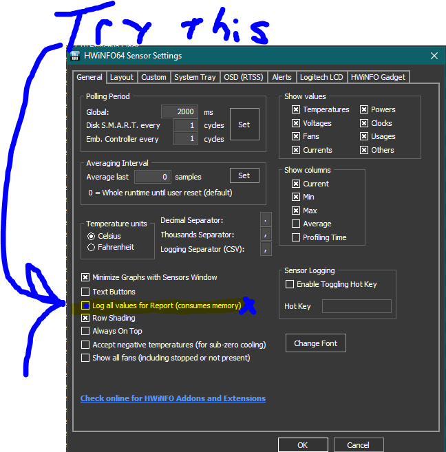

@harm9963 you do know that with paint app, if you past your screenshots there you have the ability to write with prettier letters with different sizes and color and with or without text background. It’s text function on Paint.
Will make your posts nicer and easy to read...
