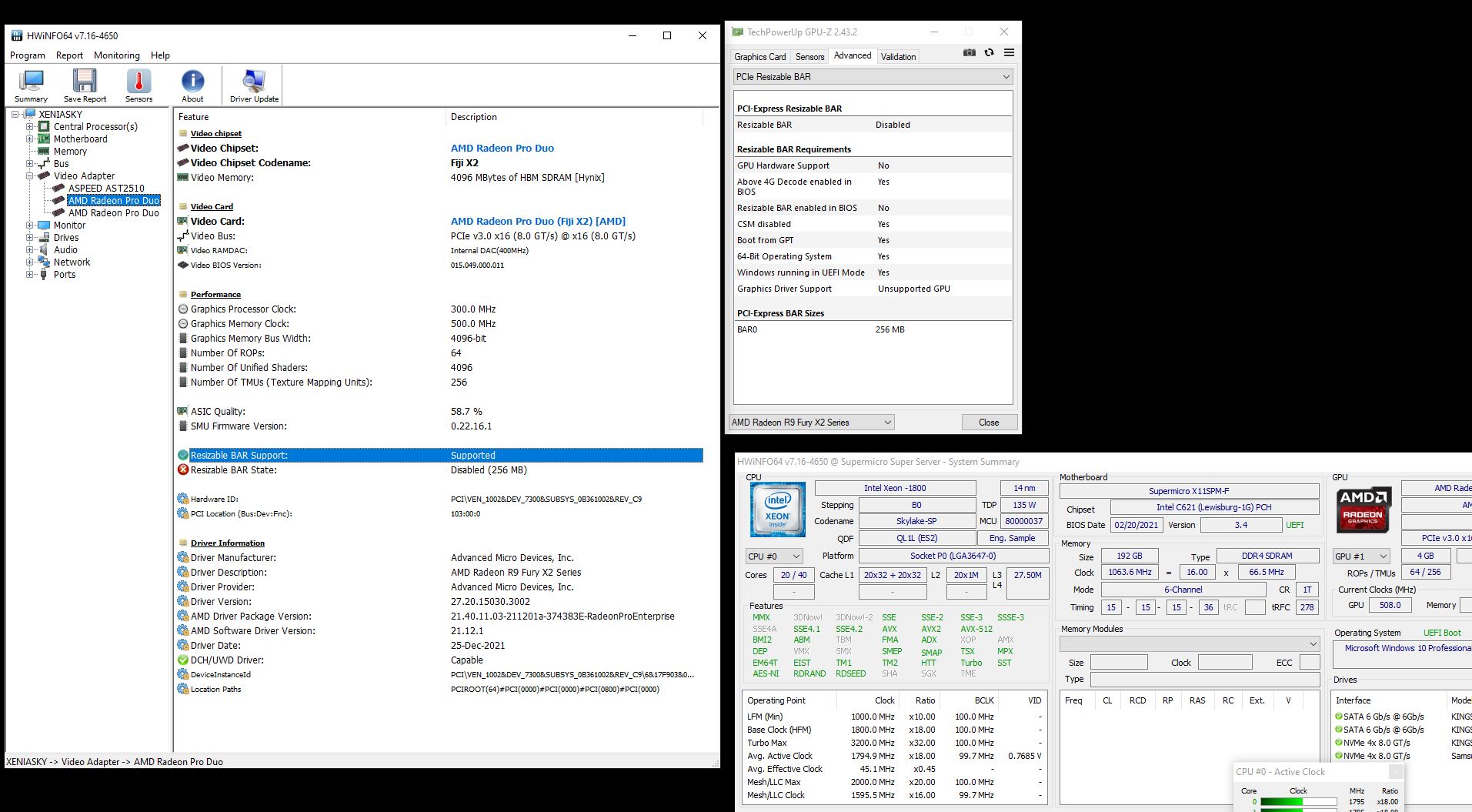

AMD Smart Access Memory not enabling in BIOS according to GPU-Z
UEFI is unchecked in his GPU-Z screenshot (leftmost one).
Windows is in uefi mode but somehow the gpu is not.
It is no display until the windows login screen show up. I dont know why. Outdated video bios?
All the oprom settings in bios is EFI mode not legacy.
Your Radeon Adrenalin 21.12.1 uses the older driver version "27.20.15030.3002".
It should be "30.0.14011.3017".
Where is that driver from?
Look again. :)

It is enabled but not working?
But the fps and the scores are better. Interesting.
I enabled the radeon driver setting in registry, because no SAM switch showing up.
What's happening is that for those two "no" entries, GPU-Z is using a hardcoded lookup table, because there is no way to detect this capability through software.
Apparently AMD has added that capability for R9 Fury (if you say performance results change), but hasn't told anyone about it

It is an xfx radeon pro duo or fury X2 not matter it is the same card
I found it: (UEFI support)
https://www.techpowerup.com/forums/...ury-series-with-improved-uefi-support.221788/
So i need vbios update for the uefi support, but there is no uefi bios for this dual card.
UPDATE:
I found an uefi bios for the master card but not for the slave
https://www.techpowerup.com/vgabios/204102/204102
now it is uefi compatible

These are the saved stock roms. the second gpu bios is litte different.
The master card is now uefi compatible, i dont know what happens if i flash the second card with the master firmware. I will try it!
UPDATE: i found a slave card fw.
https://www.techpowerup.com/vgabios/183395/xfx-radeonproduo-4096-160106
now the two card are uefi compatible and bar supported but disabled
scores a little better:
That means his GPU lacks UEFI BIOS support
the whole black screen til login thing, confirms it.
Now that's been fixed, reinstall the GPU drivers?
That only shows the GPU doesn't have UEFI mode, NOT that Windows isn't UEFI.
