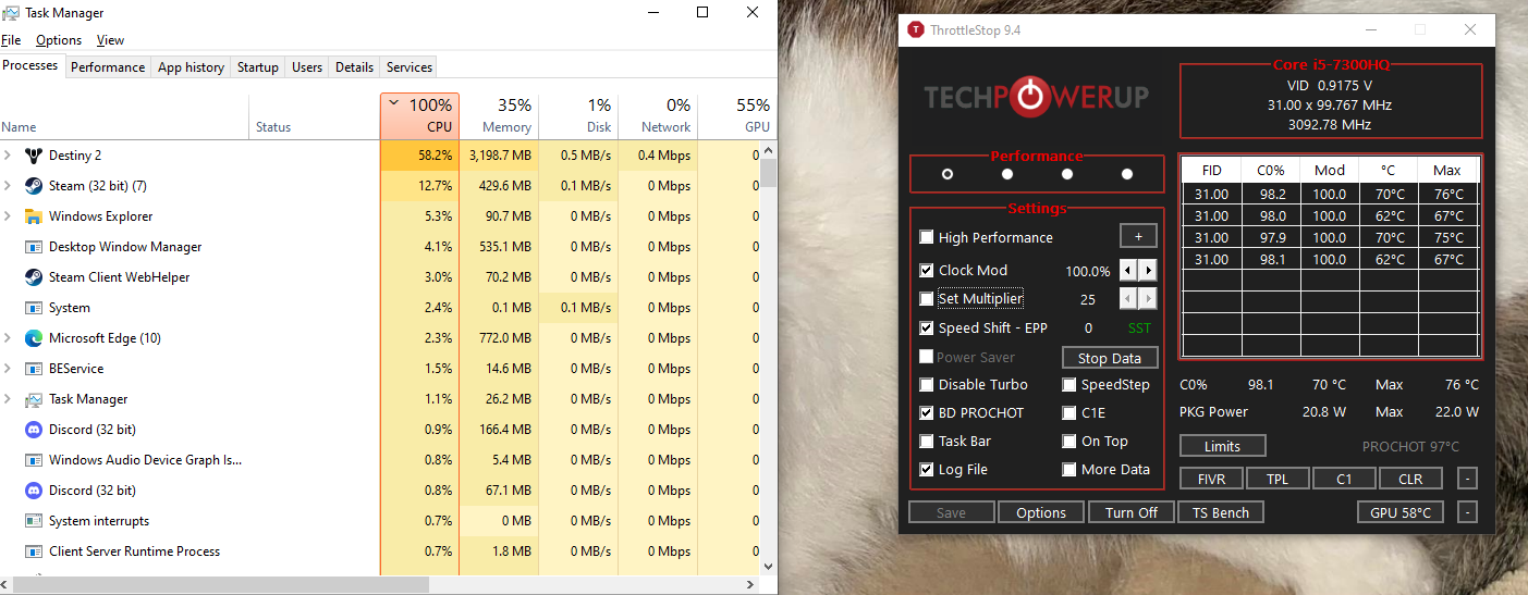

Before the fix, my game would follow the same pattern, really good for a few minutes, and then run badly, then runs well again. I included the log and a screenshot of my ThrottleStop for reference, this is probably because of the fact my CPU is kinda garbage with my mediocre GPU, but I am just curious since before the fix when my fps was fluctuated, the times my FPS was good, the fps was amazing, right before it would drop again, but still it was interesting that ever since I fixed it, (I may have done something and messed it up), but it kind of feels that my current FPS is like an average of the high fps and the low fps from before the fix.
P.S. After running the test, I do see that when my PKG power goes above 19-20, my cpu really kills itself. I believe this may be the problem, but you are the master here. I'm including a plethora of screenshots in case you need them, thanks again!

It looks like a 7th Gen 4 core CPU at 3.1 GHz and without hyper threading, combined with a GTX 1050, is no longer enough muscle for smooth gaming. The 7300HQ was a low end mobile CPU 5 years ago when it was first released.
The log file shows that 21W is the maximum power consumption for your CPU when it is fully loaded while gaming. The CPU is not slowing down or throttling. It is running at its full rated speed and it is giving all it can give. Sadly, all it can give is not enough for smooth game play.
When a CPU is running full out like this, any additional tasks that come along that need to be processed, have to stop and wait for another task to finish. When tasks start to back up in the queue like this, it is kind of like having a four lane road blocked off to one land during rush hour traffic. This is not good for smooth traffic flow just like a fully loaded CPU running at 100% is not good for smooth game play.
When your computer is idle at the desktop with only ThrottleStop open, what does ThrottleStop show for C0%? For comparison, fast desktop processors with lots of threads available can average 0.1% in the C0 state when idle. A 4 core CPU like you have should be somewhere around 1.0%.
It takes very little processing power to run all of the Windows background tasks when it is properly setup. The only way for you to improve performance is to reduce the background tasks so your CPU is not so overloaded. Look in the Task Manager Details tab to see if there is anything that does not need to be running. Work on lowering the idle C0%. Your CPU is overloaded. It needs all of the help it can get.
