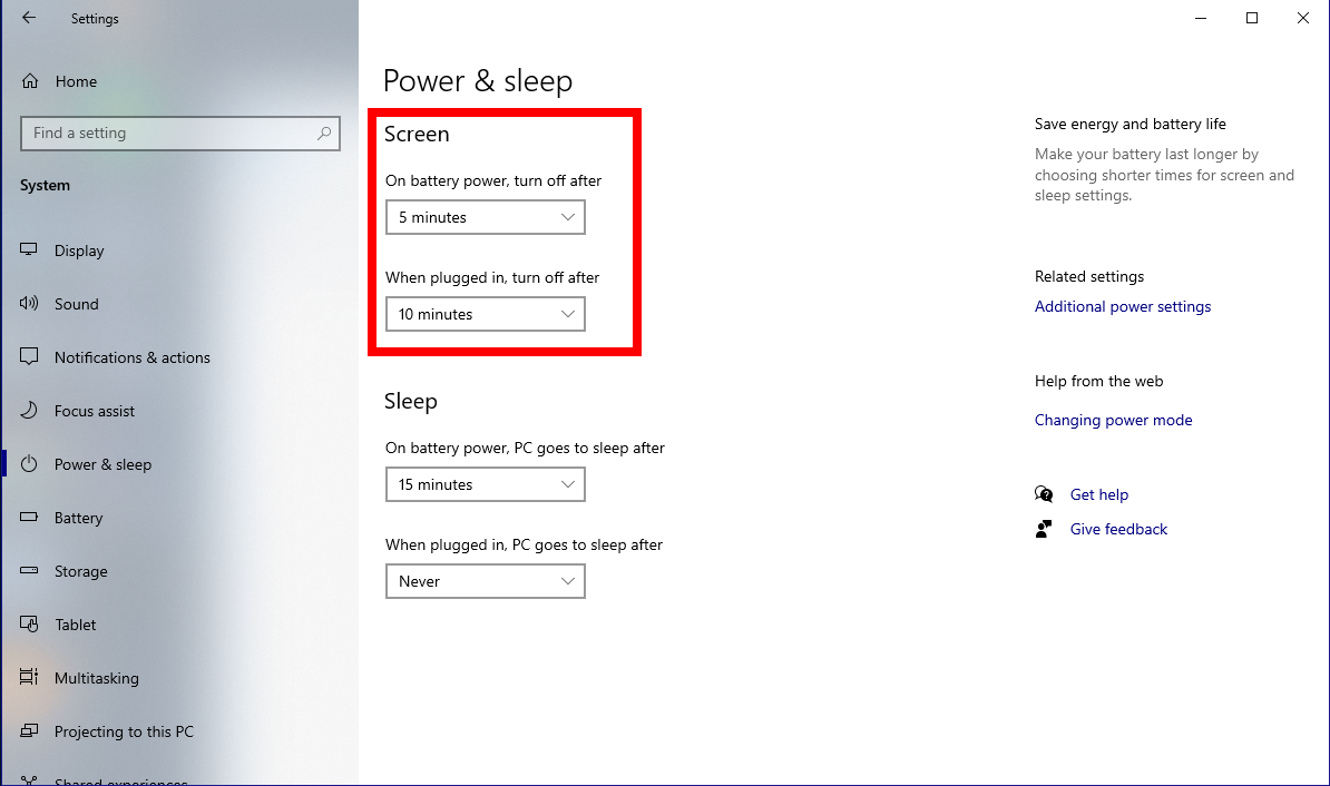

Like, wow, there is literally a setting in Windows that says "Turn off monitor after" and it lets you pick how long in minutes. And after that time, the monitor is turned off, but the computer still continues to run.
I seriously can't believe there are actually people that don't know this very basic knowledge, and are actually trying to say this basic function of computers is actually a malfunction AND trying to give other advice on power usage. Like WTF?!?
But since you seem to be so dead set that you can't put a monitor to sleep without putting the whole computer to sleep or turning it off, please tell me what this setting right here is for then:
Seriously, tell me what it does. Don't even bother to respond if the answer to what that setting does isn't the first thing in your post.

When Windows puts the monitor to sleep, all it is doing is cutting the video signal to the monitor, the same as when the computer is put to sleep. What the monitor chooses to do with this, and what is displayed varies depending on the monitor.
However, the state that the monitor is in is the same if the computer is turned off, or if Windows puts the monitor to sleep.
The difference in time for the monitor to wake up between when the computer is in sleep and when just the monitor in in sleep comes down to the fact that the video signal is not restored to the monitor instantly when waking a computer from sleep. There is a second or two delay after you wake the computer before it begins outputting a signal to the monitor. However, when just the monitor is put to sleep, the video signal is output immediately when you move the mouse or press a key.
