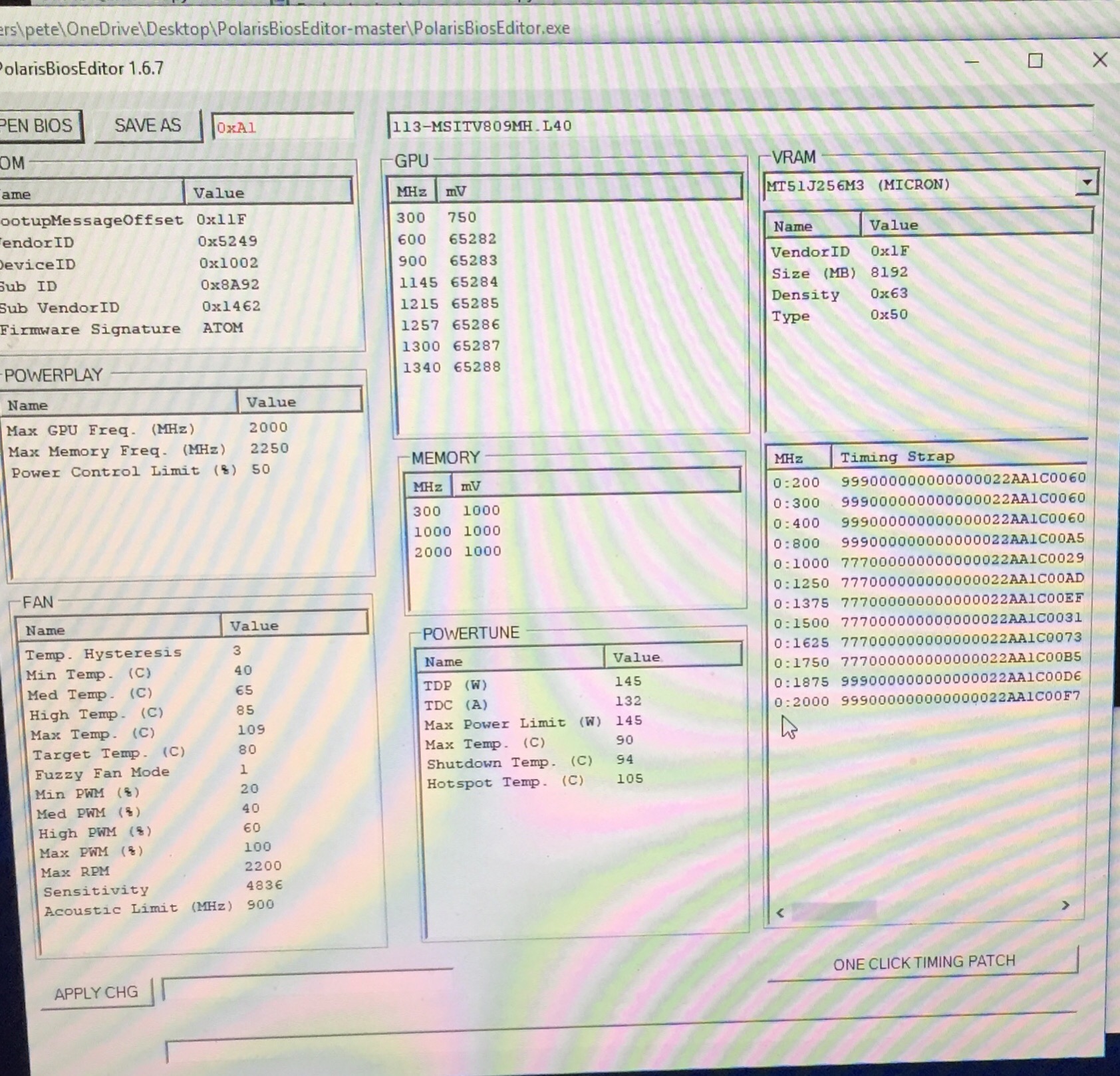

These two files are my original bios and the anorak modded bios. In Polaris bios editor. Does this help?
Looks like micron memory.
