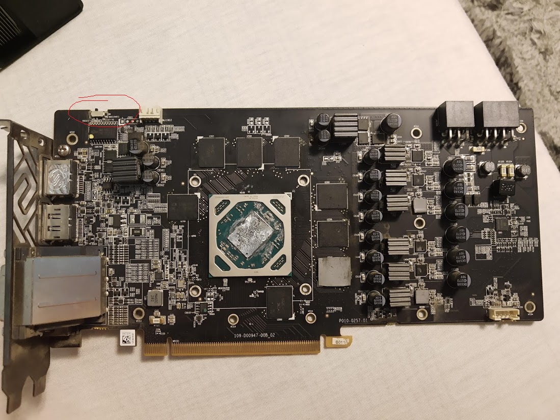

It looks like a NITRO+ from the outside and the sticker on the fan shroud points to an RX580 4GB but when I took off the heatsink, I found this:
AHltqHKZV-wevTmnYqSJEAfdsWbRnLKpUkfoRYpVQ1aYMe-ymzKUIxCghoGvxT_dK8HSCXUeSNvsUZlWi3X04-6syWqvrKlKW0Ty5Q--8ISUbrEn6Wx2XXUyhLWKP-hrNIKfOqHRKMLvt5xpkQXXZELIPr3mUQYJnv0KwcdVzZjHvNiWeaNm_Mz6MYWrw_cJu1_2CStjLDWDzyaZ3aHq86sh3j7b9n9tEY_DusMuGTno6vB7CIsiTg_5rCJ4A_JxM9i0afxrbxApFgfOwiMfneZGxYo1raZReO465VUBLLwS-yuTAcm7d-BqeG1UNNVw47apGe4CWE-cKbY9NX9DX-GSnJT_OGqNnrub0vuxau2_FeonPkuYdMko7LFZJZsgRuCM2FMKpzjE67TW45HzoSPJl9-ivLTH7Bcct0yETyzWTujrofDLMLJQx7Ce6v5OxCvHUd1qqPurecDNGyI57_Mal-btYImWgxusi7ZgutHbk6v4fZI0YITNTyxk9A_eQ9hIzMQLNjH35V5nCqSv02V_7KC5ULsuuz07wq4kNbJN48eujR9JdRmyGzWAfRP0f1iY0drwBtYh0umvidmLHTi8YyDNnY79uRk1Uh9GikqApcBS8bSHyFDhsTxozXwvN3e6gVJNShfZ62r2u97TmbkH8awFbrnAqM_t80nWp4fVbjJ2SwVdRtx_XvaOlKaNS3v34KhC5wiRy9dd1zzR6Fob=w1099-h824-no
which is most likely an RX570
there are 8 SAMSUNG memory chips around it, but i cant really read the chip part number

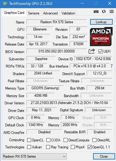

And here's what info GPU-Z gave me:
Can I make this card work by flash the right VBIOS? If yes, where can I get it from?
try flicking the bios switch and see what it does.

Sure thing. In the meantime, switching back to BIOS 1, with that bios switch, I entered GPU_Z again, to find this:
2304 shader units. Doesnt that mean its an RX580?
Also, only 160MB of VRAM were read.
and afaik, its supposed to be a Polaris GPU if it's An RX 5XX

From the last picture i was able to identify exact model of your card : Sapphire Nitro Radeon RX 580 4gb - with Samsung memory chips
From one of the pictures where you zoomed on the video chipset, (GPU die number) - i noticed plenty of arctic paste on the components that surrounds the video processor.
You should fast clean that up, because that arctic cooling paste contains silver that is a very good electricity conductor.
So 1st : you clean up with a ear bud all area surrounding the video processor
2nd : you use isopropilic alcohol with ear buds to clean the rest of the arctic paste that will be stuck in the small pieces that surrounds the video processor
3rd : you will use the original BIOS for your card to reflash it to restore it to factory default
4th : you give it a try (should work at that time at full speed)
You can tell what brand thermal paste is on the chip just by looking at it? :rolleyes:
It was obvious to me it is a RX580 4GB and the sticker on the shroud should have been in the initial post, not some assumption it may be a RX570
p.s. Arctic Silver is NOT good at being electrically conductive.
it was not an assumption. If you look at the numbers on the die, it's an RX570 chip

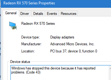

After flashing an RX570 4GB VBIOS, the card is identified correctly in GPU-Z but i still get error 43 in windows, and the PC wont post without an additional VGA card.
So after all you flashed a 570 BIOS instead 580 as it should ?

Damn. This is really weird... Have you tried re-install the driver? Maybe that would help.
But I think that we still haven't found the exact VBIOS... Try multiple times.

Well about miner version BIOS...it should work normally under windows, more then this it should let you install the drivers and start working under windows environment.
If you got that nasty 43 error probably who sold you the card tried several BIOS on it and you do not have a working BIOS for it.
So yeah , you have a huge work to do....you must test a lot of BIOS-es until you will find the right one for you.
