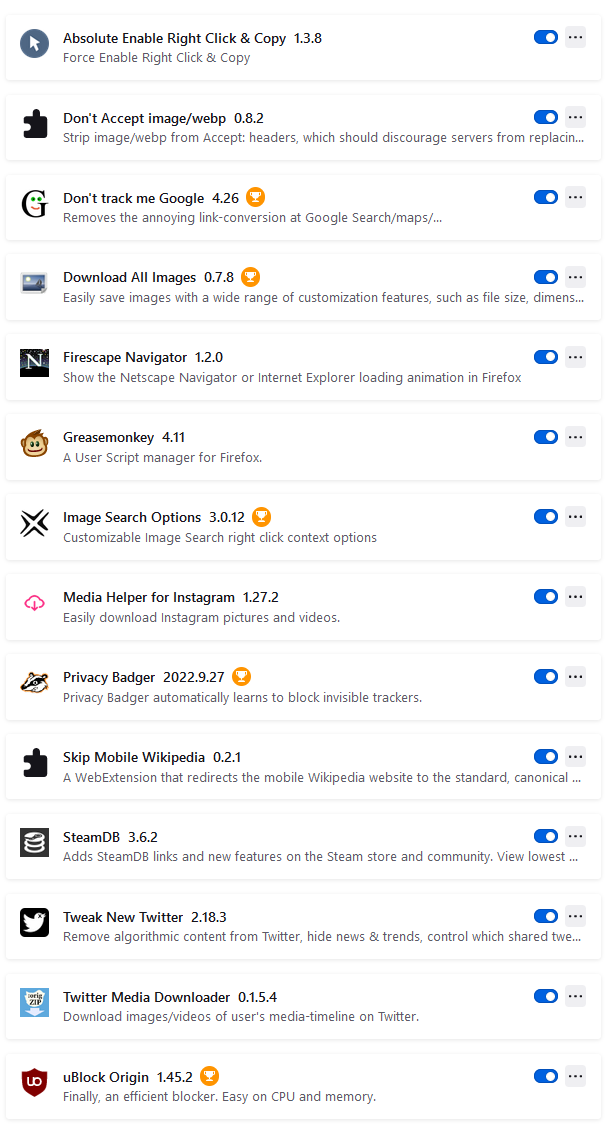

Here's my add-ons. But like I said, issue is still present with them disabled, so it can't be anything to do with them.
Nothing there seems out of sorts. I'd try turning the Stream, Twitter and Instagram extensions off and restarting Firefox to see if you notice an improvement. See below.
