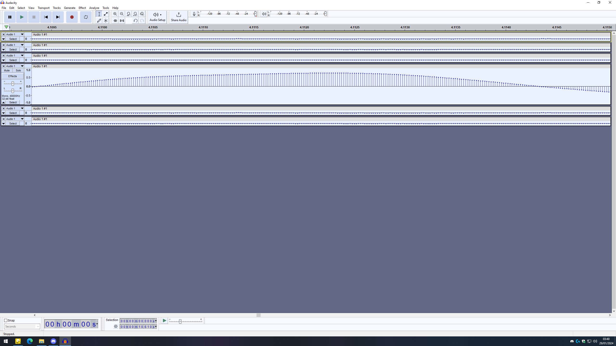

Two images below, the second image is zoomed in, notice the LFE channel is the loudest.
Note that Audacity captures after SFX, and it seems not after MFX.
Edit: In the second image, the audio has not yet clipped, just beyond the meter.
