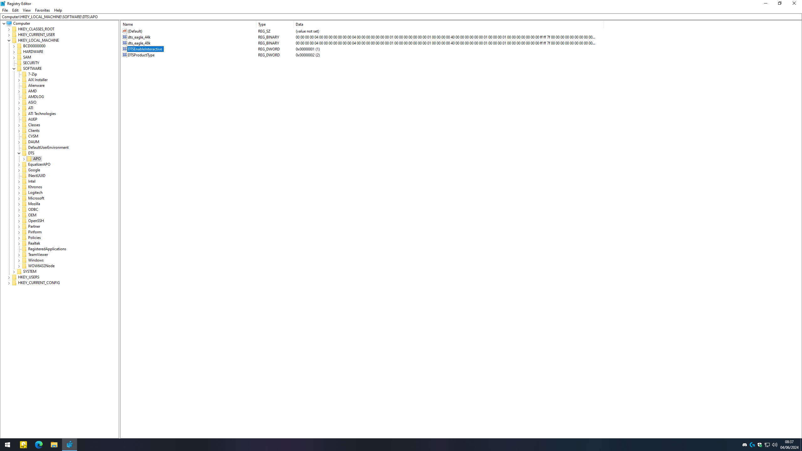

If you want to turn off DTS Interactive and use 2 channel PCM, set below to 0.
You might need to disable-enable the endpoint to refresh it after.
HKEY_LOCAL_MACHINE\SOFTWARE\DTS\APO
